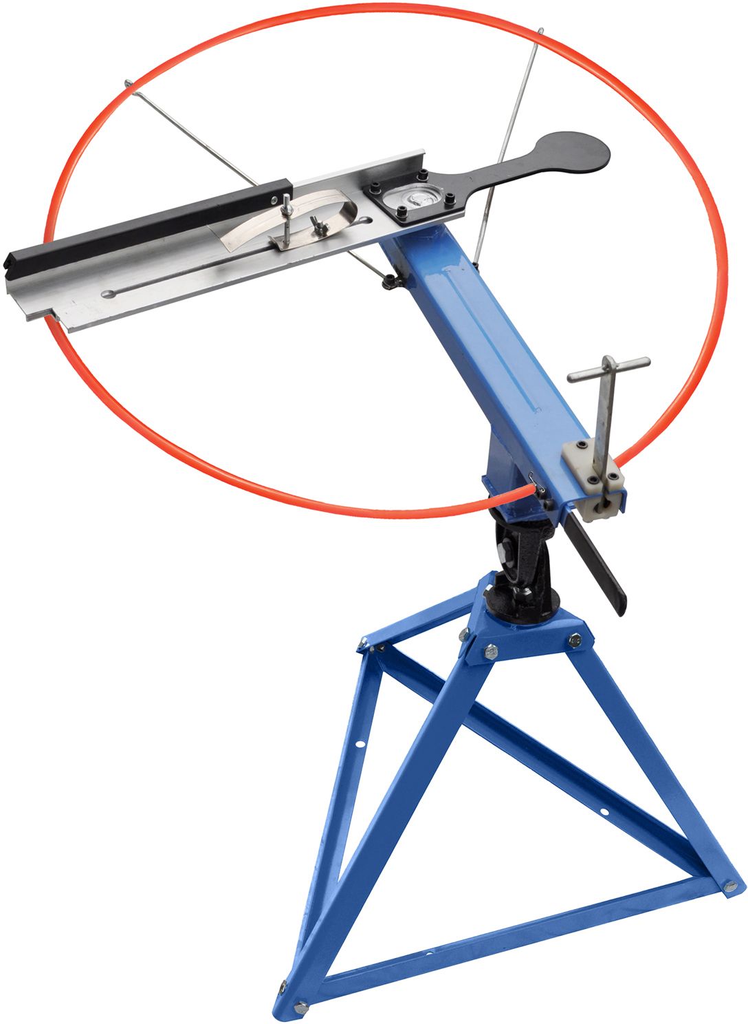

Hello everyone,
I am a mechanical engineering student and was given the task to design a very accurate projectile launcher within a distance of 10 to 20 meters. It should be adjustable within that range and portable by one person. Accuracy is the most important though. I was thinking of a crossbow operated with a spring or a skeet shooter would fit the description well. Any ideas would be highly appreciated. Thank you in advance

What about natural gas as a propellant? You could make a mini artillery piece. Maybe you could use some parts from a car like spark-plug, fuel injector etc.
Presumably, firearms are not allowed. What are the complete and accurate requirements that you're working with?

Thank you everyone for your prompt responses. Thank you @berkeman for moving it into the appropriate topic, I was not aware.
The main factor affecting range will be the launch velocity and the launch angle. The release of trigger mechanism needs to be operated from at least 1.5m. The maximum operating force is 50N (which could be used to create a larger force through transmission) and the projectile is a 120g bean bag.
The resources available are steel and aluminium tubes, sheets, plates and round bars. Chains, bearings, belt drives and gears could be selected from standard catalogues. Principal design tasks are energy storage method, a mechanical ‘transmission’, launching mechanism and overall design.
The main aim of the task is to be able to adjust the range of the launcher based on a mathematical model between 10 and 20m reliably and most importantly very accurately. We thought about multiple methods such as trebuchet or mangonel but arrived at skeet shooters and a spring operated crossbow due to their high accuracy, adjustability and convenient trigger mechanism.
If there are any other opinions about this, they would be highly appreciated though. Thank you!
So once the correct launch velocity an angle have been found the next thing will be ensuring those and the results are repeatable. You might want to consider what factors might effect the flight path of a bean bag and is there anything you can do to make it more repeatable.
What is the beanbag put in for the launch? Are you given a standard cup of some sort, or just given the beanbag? If the latter, can you stuff the beanbag in a more aerodynamic container with directional stabilizers (like a little rocket ship shape)? Or is is supposed to just be a beanbag blob from start to finish?
(See what I mean?)
Okay, other questions/ thoughts:
In my practical experience, skeet pigeon launch arms are notoriously variable. Are you sure about trying to use that paradigm? And a crossbow design would probably only be accurate if you can use the stuff-the-beanbag-in-the-model-rocket trick I mentioned above...
Fun project overall, but please give more info, and think more about what-all is involved in great accuracy in projectile motion. BTW, will you be filing a report of your group's work too, or is the full grade just based on the accuracy performance in the final testing?

Thanks again for the quick replies!
We are free to choose where to put the beanbag. However, we cannot edit the ball. The focus is on the launcher itself.

What do you mean by "a mathematical model"? You are not allowed to fine-tune your settings and calibration constants with experiments?
We can experiment, however we are given the aim (which will be between 10m and 20m) on the day and need to adjust accordingly. Therefore, we need to come up with a model that allows us to adjust the angle and tension so the projectile is as close to the aim as possible. We cannot test it on the day.

We will have a report too. The main point of the project is to design a launcher whose angle and launch velocity can be adjusted using a model in order to accurately land it reliably on a target in a range between 10m and 20m.

Thank you for the reply, that was very helpful. Due to portability issues, we decided against the trebuchet. Thank you again for the answers!
