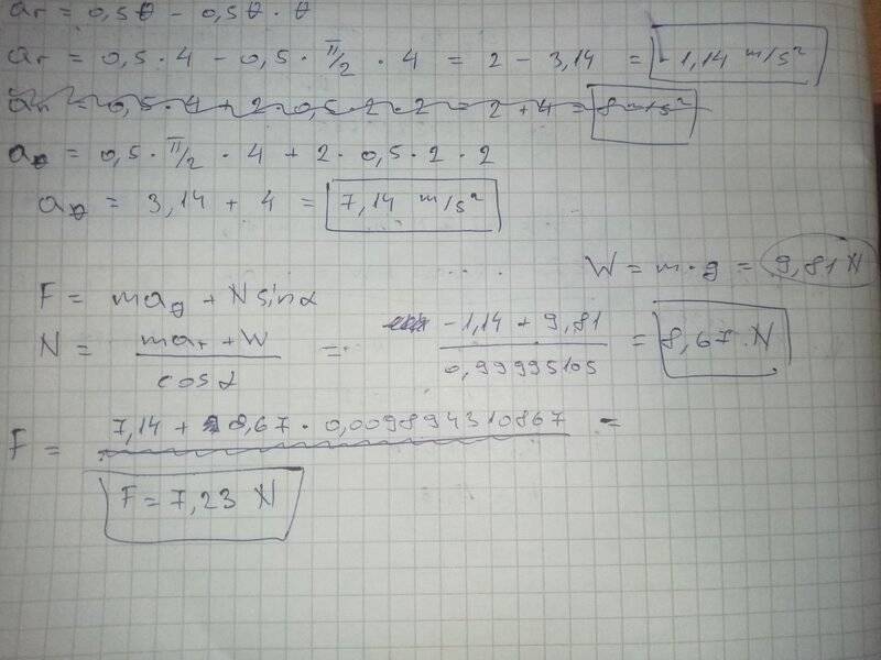

Can someone find mistake?
Correct answer is 12,66N.I am learning LaTeX !
In the future, a new problem should be posted in a new thread.
I believe the only mistake you made in your solution for the new problem is that your calculator was in degree mode while your angles are expressed in radians.

I get correct answer now.
Thanks !
