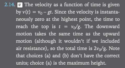

You throw a ball straight upward with initial speed ##v_0##. How long does it take to return to your hand?
##v=v_0+at##
##x-x_0=v_0t+\frac{1}{2}at^2##
My question is a general one that relates to the described solution.
According to the text, the time to reach the top of the flight is ##t=\frac{v_0}{g}##.
It then goes on to say that the downward motion takes the same time as the upward motion, so the total time back to the ground is ##\frac{2v_0}{g}##.
But why would the time to the ground be the same as the time to the top? My confusion lies in the fact that on the way up, we have an initial velocity not equal to zero. On the way down, the initial velocity is zero, so it wouldn't start out going as fast as the first part of the parabola. Then I thought that the first part of the parabola, although it has an initial velocity not equal to zero, does slow down throughout it's entire flight up. In contrast, on the way down, it has an initial velocity of zero but is speeding up until it hits the ground.
So my question is, do these two halves of the parabola always balance out? That is, will the initial velocity of the first half of the flight, be equal to the final velocity of the second half of the flight?

Here is the solution description.

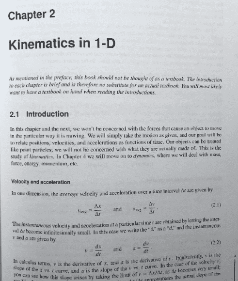

I'm just calling it what it says in the text. I'd call it what people are familiar with, but this is all I've seen it referred to as. I was just confused as to why we could say the time to the top was the same as the time to the bottom as it was kinda just stated in the text without explanation but was important in solving it symbolically.
