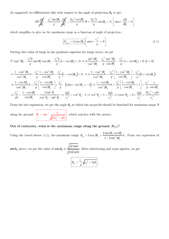

Sorry for the delay, but I have good news. Please see through my calculation when you have the time, specially my finding of the maximum range ##R_{\text{max}}##.
We had the following quadratic equation for the range ##R## (see above) : $$R^2 - \frac{v_0^2 \sin 2\theta_0}{g}R-\frac{v_0^2 h}{g}(1+\cos 2\theta_0)=0$$
I type the remaining using a combination of MSWord and MathType for faster typing. I hope am not violating anything.
Is my working correct above? Sorry for the poor size of the image.
Well done.

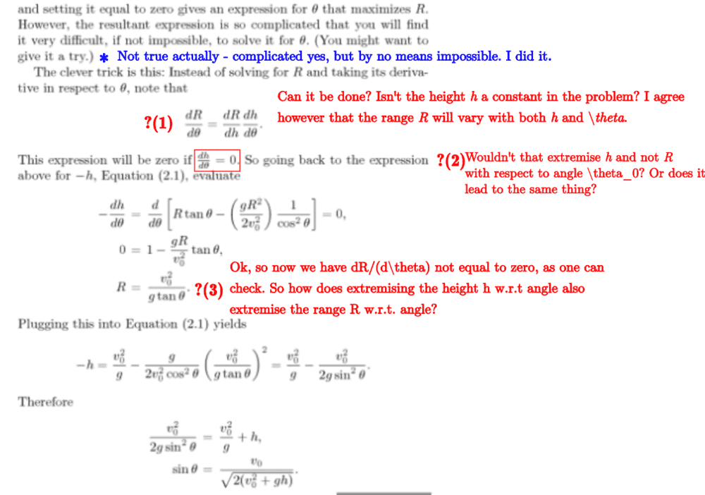

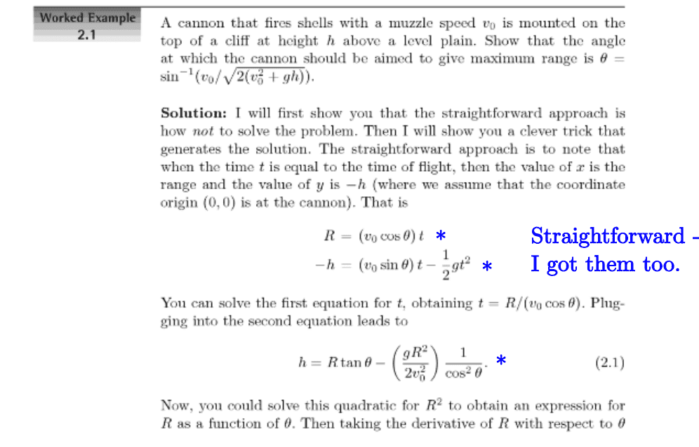

Thank you. However, my problems don't end there. The author whose book I am following has given a shorter way to do the problem which, for all its elegance, leaves me wondering and confused on several points. I will copy and paste the author's solution and marks appropriate places blue asterisks (*) which I get and red question marks (?) for places where am confused. I will go on to explain what my confusions are.
Thank you for your time.
Author's question and solution : (sorry for the cloudy font and text)

I'm with you, the reasoning given is quite invalid.
But the algebra worked for a different reason. In differentiating (2.1), since h is constant, dh/dθ=0, so choosing to set it zero is fine. On the RHS, the full form of the derivative would include dR/dθ terms, but since we want the extreme of R wrt θ these go to zero. Consequently the equation obtained is valid. Indeed, this turns into exactly the method I used.

Let's see the calculation. You can't leave an answer in terms of an unknown angle ##\alpha##.
The correct answer is: $$R = \frac v g \sqrt{v^2 + 2gh}$$
Where ##R## is the maximum horizontal range. I don't see how you are getting that.

I concur that it does. You can see that from the expression for the range in post #8. Maximum range is obtained when the final and initial velocities are perpendicular.$$R_{\text{max}}=\frac{v_0v_f}{g}$$ From energy conservation ## v_f=\sqrt{v_{0}^2+ +2gh}##. Then $$R_{\text{max}}=\frac{v_0\sqrt{v_{0}^2 +2gh}}{g}.$$

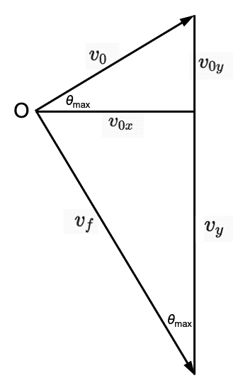

To complete the picture, when the range is maximum, the initial and final velocity vectors form a right triangle as shown below.
From the velocity triangle, $$\tan(\theta_{\text{max}})=\frac{v_0}{v_f}=\frac{v_0}{\sqrt{v_0^2+2gh}}.$$ Applying the trig identity for the sine in terms of the tangent verifies the answer posted in #1. It is interesting to note that the product $$R_{\text{max}}\tan(\theta_{\text{max}}) =\frac{v_0^2}{g}$$ is independent of the height of the cliff ##h##.
