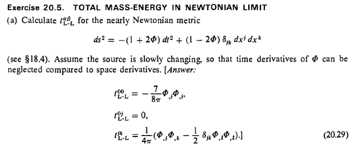

MTW Exercise 20.5 -- prove ∇2Φ=4πρ

I have a couple of issues with this problem, but first of all, I want to find out what I am missing in my attempt to prove ##∇^2Φ = 4πρ##
See below
[/B]
If ##Φ = \frac {-M}{r}##
Then ##Φ_{,i} = \frac {Mx^i}{r^3}##
So ##Φ_{,ii} = \frac {-3Mx^ix^i}{r^5} + \frac {M}{r^3} = \frac {-2M}{r^3}##...(1)
Taking ##ρ = \frac{M}{V} = \frac{3M}{4πr^3}##
Gives ##Φ_{,ii} = \frac {-8πρ}{3}##
Not what I wanted at all!

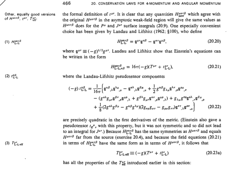

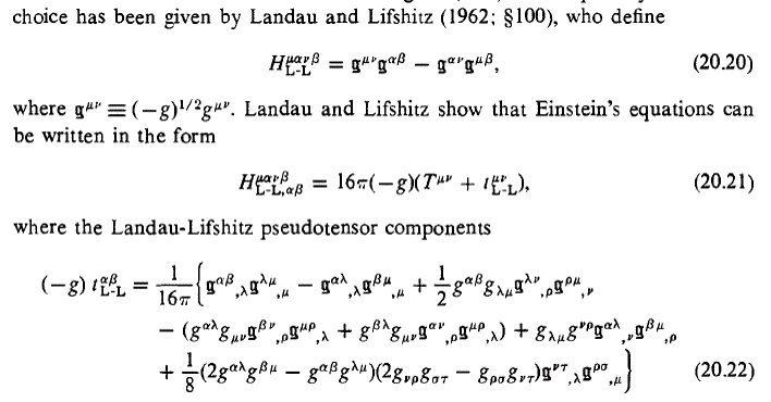

Terry,
I believe MTW expect you to work part (a) using (20.22), which you were able to do according to your post #9. The pseudotensor ##t^{00}_{L-L}## is defined by (20.22).
Note that ##T^{00}## and ##\varphi## for this part of the problem have not been specified. In particular, ##\varphi## is not necessarily equal to ##-M/r##. As I understand it, part (a) is dealing with a general "nearly Newtonian metric" (discussed in section 18.4) with a general Newtonian potential ##\varphi##.

So the conclusion is that I can't go down my initial route because:
"##T^{00}## and ##\varphi## for this part of the problem have not been specified. In particular, ##\varphi## is not necessarily equal to −M/r. As I understand it, part (a) is dealing with a general "nearly Newtonian metric" (discussed in section 18.4) with a general Newtonian potential ##\varphi##."
(I tried to use QUOTE for the above but it didn't come out well!)
I did get the required results using 20.22, so I should be happy about that.
I've resolved my problem with part (b) so Exercise 20.5 is done!I've just reached the end of Chapter 20 and completed Exercise 20.9, getting the result φ,αα = 0. Is this correct? Regards
