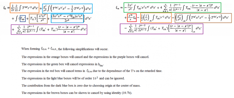

Hi TSny,
I've been batting this around for a few days now and have reached a bit of a road (mind) block. To try make a bit of progress, I'm going to set out my working in stages, starting with my thoughts on what h0m, ξ0 and ξm are:##h_{0m} = 4\int(T'_{0m})\big(\frac {1}{r}+\frac{x^jx'^j}{r^3} \big)d^3x' ##
(This is as suggested, the n = 0 term of (19.2) - I can't see how this can be simplified! I also observe that ##4\int(T'_{0m})\big(\frac{x^jx'^j}{r^3} \big)d^3x' ## can provide the term in ##h_{0m}## that we are seeking!)
I've adopted a slightly different convention in labelling, using ##x'^j## instead of ##x^{j'}## which, to me, makes clearer which point the coordinate refers to.
## ξ_{0} =\frac 1{2r}\frac{\partial}{\partial t} \int(T'^{00})r'^2d^3x'##
##\quad+\frac{x^j}{r^3}\int(T'^{0k}x'^j x'^k - \frac{1}{2}T'^{0j}r'^2)d^3x'##
##\quad+\int(T'_{00}+T'_{ll})\frac{x^j x'^j}{r}d^3x'##
##\quad+\frac{1}{2}\int(T'_{00}+T'_{kk})_{,0}\big(\frac{x^j x'^j}{r^2}\big)^2\big(\frac{1}{r}\big)d^3x'##
## ξ_{m} =4\int(T'_{0m})\big(\frac{x^jx'^j}{r} \big)\big(\frac{1}{r}\big)d^3x''## (n = 1)
##\quad +4\frac{1}{2}\frac{\partial}{\partial t}\int(T'_{0m})\big(\frac{x^jx'^j}{r} \big)^2\big(\frac{1}{r}\big)d^3x'##
##\quad +\frac {x^m}{r}\frac 1{2r}\frac{\partial}{\partial t} \int(T'^{00})r'^2d^3x'##
##\quad +\frac {x^m}{r}\frac {x^j}{r^3}\frac{\partial}{\partial t} \int(T'^{0k}x'^j x'^k - \frac{1}{2}T'^{0j}r'^2)r'^2d^3x'##
##\quad +\frac {x^m}{r}\int(T'_{00}+T'_{ll})\frac{x^j x'^j}{r^2}d^3x'##
##\quad +\frac {x^m}{r}\frac{1}{2}\int(T'_{00}+T'_{kk})_{,0}\big(\frac{x^j x'^j}{r^2}\big)^2\big(\frac{1}{r}\big)d^3x'##
##\quad -\frac {1}{2}\big(\frac 1{r}\big)_{,m}\int(T'_{00})r'^2d^3x'##
##\quad -\big(\frac{x^k}{r^2}\big)_{,m} \int(T'^{0j}x'^j x'^k - \frac{1}{2}T'^{0k}r'^2)d^3x'##
##\quad -\frac{1}{2}\int(T'^{00}+T'^{kk})\big[\big(\frac{x^j x'^j}{r^2}\big)^2\big(\frac{1}{r}\big)\big]_{,m}d^3x'##
Do these look OK to you?RegardsTerryW

OK. The first term on the right in your expression for ##h_{0m}## can be shown to equal zero via MTW (19.4a). Yes, the second term can be rewritten in terms of the angular momentum ##S^k## and an extra term that will get canceled in the gauge transformation. Also, ##h_{0m}## will include the summation over n for n ≥ 1. But this will get canceled in the gauge transformation.
I have not checked all your terms in ## ξ_{0}## and ## ξ_{m}##. I did not modify any of the terms in these expressions as given in MTW. I've attached a figure that shows the role of the various terms of the gauge transformation for ##h_{0m}## as I see it.

Hi TSny,
I've worked my way through your rationale for getting rid of the unwanted terms in ##h^{new}_{0m} = h^{old}_{0m} - (ξ_{0,m}+ξ_{m,0})## but I think that there are still quite a few bits hanging around!
1. The expressions in the orange boxes cancel.... agree
2. ...and the expressions in the purple boxes cancel - I think that the sum of the purple boxes is -
$$ \sum_{n=0}^\infty \frac{1}{n!}\frac{\partial^{n-1}}{\partial t^{n-1}}\int(T'_{00}+T'_kk)_{,m}\frac {(r-|x-x'|)^n}{|x-x'|} d^3 x' \quad (A)$$
3. The contribution from the dark blue box is zero due to choosing the origin at the centre of mass...agreed.
4. The expression of the brown boxes can be shown to cancel using identity (19.7b)...agreed.
5. The expression in the green box will cancel expressions in ##h_{0m}## ... ##h_{0m}## contains only terms with ##T'{0m}## so ##h^{new}_{0m}## will still end up with a term -
$$ \frac{2x^j}{r^3}\int T'_{00,0}x^j x^{m'} d^3 x' \quad (B)$$
6. The expressions in the light blue boxes will be of order 1/r3 and can be ignored. I don't think this is correct. In 19.5, the term ##\frac{x^l}{r^3}## isn't ignored. The unprimed co-ordinates refer to the location of the observer and as such, some of the values of xl will be of the same order as r. You could maybe argue that all the terms in ##ξ_{0,m}## disappear by taking the partial derivative under the integral sign and then use the divergence theorem but then you would bring back terms from ##ξ_{m,0}## that were eliminated above!
7. The expression in the red box will cancel terms in ##ξ_{0,m}## due to the dependence on the T's on retarded time. If you had made this your final statement, it would have become invalid because there are no parts of ##ξ_{0,m}## left to cancel. It just appears to add four more terms to my collections of terms not yet eliminated.To summarise, I still have the following terms hanging around:
From ##ξ_{0,m}## :
$$\frac {\partial}{\partial x^m}'\big( \frac {x^j}{r^3} \int (T'^{0k} x'^k x'^j - \frac {1}{2} T'^{0j} r'^2 )d^3x' \big)\quad(1)$$
$$\frac {\partial}{\partial x^m}\big( \int (T'_{00} + T'_{ll})(\frac {3x'^j x'^k - r'^2 δ_{jk})x^j x^k}{2r^4} d^3x' \big) \quad(2)$$
$$ \sum_{n=0}^\infty \frac{1}{n!}\frac{\partial^{n-1}}{\partial t^{n-1}}\int(T'_{00}+T'_kk)_{,m}\frac {(r-|x-x'|)^n}{|x-x'|}d^3 x' \quad (3)$$
From ##ξ_{m,0}## :
$$ \frac{2x^j}{r^3}\int T'_{00,0}x^j x^{m'} d^3 x' \quad(4)$$
$$\frac {x^m}{r} ξ_{0,0} \quad (5)$$
If it is indeed OK to take the partial derivative behind the integral sign and then use the divergence theorem, then we can eliminate (2), but that still leaves four terms to argue away, with ##\frac {x^m}{r} ξ_{0,0}## looking particularly challenging.
I'll continue to explore this to see if 19.7a,b and c can provide further assistance.RegardsTerryW
Every term in ##\xi_0## produces a "retarded time" term when evaluating ##\xi_{0, m}##. All of these retarded time terms are canceled by terms generated by the red box term in ##\xi_m## when evaluating ##\xi_{m, 0}##. So, the orange and purple boxes cancel after taking this retarded time cancellation into account. Thus, your extra term that you are getting from the purple boxes is canceled by a particular term generated by the red box when evaluating ##\xi_{m, 0}##. [Edited to correct subscripts.] (The summation in your left-over purple term should start at n = 2.)
More explicitly, in your left-over term you have ##(T'_{00}+T'_{kk})_{,m}##. Show that due to the retarded time dependence, this is equal to ##\left( -\frac{x^m}{r} \right) (T'_{00}+T'_{kk})_{,0}##. Then show that the red box will generate a term that will cancel your left-over term.
Similarly, all the terms in ##\xi_{0,m}## that are due to the dependence on the retarded-time will be canceled by terms in ##\xi_{m, 0}## that come from the red box expression in ##\xi_m##. [Edited for clarity.]

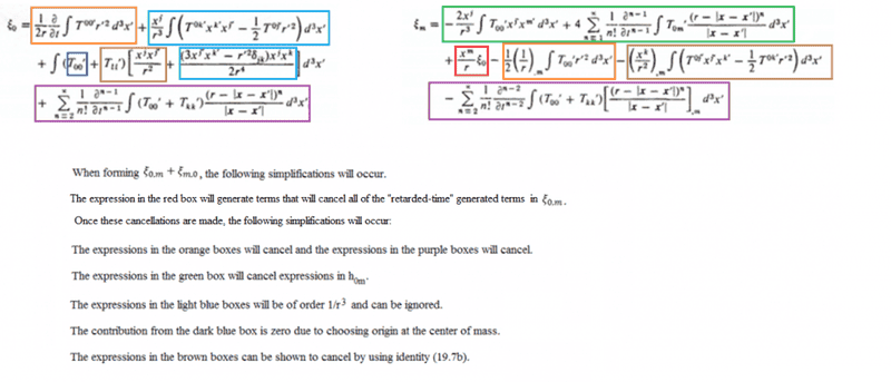

In taking the spatial derivatives with respect to ##x^m## in (1) and (2), you will either make the terms of order 1/r3 or you will produce "retarded-time" terms that will be canceled by terms in (5). Likewise, (3) gets canceled by (5). (4) is zero in the center-of-momentum frame.

Hi TSny,
Your previous post and updated figure has clarified the process of elimination and I can now see that the terms:
disappear.
But I still think that there are two terms unaccounted for.
1. In one of my earlier posts, I had incorrectly written the first term of the green box as
$$-\frac {2x^j}{r^3} \int T_{00} x^{j}x^{m'} d^3 x'$$
which you commented on and said that it is zero in the centre of momentum frame. A close look at MTW shows this first term to be
$$-\frac {2x^j}{r^3} \int T_{00} x^{j'}x^{m'} d^3 x'$$
which I don't believe is zero in the centre of momentum frame.
2. I still don't agree that the expressions in the purple boxes cancel. The retarded time term from ##ξ_{0,m}## has already been canceled by a term from the red box, but it will still produce two terms when the differentiation wrt xm is carried into the integral. One of these terms is canceled by the purple box on the right hand side, but we are still left with:
$$\sum_{n=2}^\infty \frac{1}{n!}\frac{\partial^{n-1}}{\partial t^{n-1}}\int(T'_{00}+T'_{kk})_{,m}\frac {(r-|x-x'|)^n}{|x-x'|}d^3 x'$$
I've tried to find a way to use 19.7 a,b and c to get these two terms to cancel without success.
If you can help me to resolve this, I promise not to do a post if I can't sort ##h_{mn}##!
RegardsTerryW

OK. But I don't understand the prime on the derivative operator in (1).
Right, this term is not zero. But when forming ##\xi_{m,0}##, this term will cancel an unwanted term in ##h_{0m}## when doing the gauge transformation.
I think this is the retarded time term that gets canceled by a term from the red box.

Right, this term is not zero. But when forming ξm,0ξm,0\xi_{m,0}, this term will cancel an unwanted term in h0mh0mh_{0m} when doing the gauge transformation.
It can't. All terms in ##h_{0m}## contain ##T_{0m}## and the second term in your green box covers all the terms in ##h_{0m}## for n>0.
I don't think it is. The retarded time term is the term in the left hand purple box differentiated wrt x0 (t) and it includes the -##\frac {x^m}{r}## term, like the terms in the red box. My term arises from the differentiation of the product ##(T'_{00}+T’_{kk})\frac {(r-|x-x'|)^n}{|x-x'|}## wrt xm which produces two parts, only one of which is canceled your right hand purple box.
After some manipulations and the use of (19.7c) I get (to order 1/r^3) the following:
##h_{om} = -2 \epsilon_{mkl}S^k\frac{x^l}{r^3} - 2 \frac{x^j}{r^3}\int \left( T^{00 '}x^{m'}x^{j'} \right)_{,0} d^3x'## + a summation term over n.
The middle term is canceled by the first term of the green box and the summation term is canceled by the second term of the green box.
All of the terms that I call "retarded time terms" are terms that come from differentiation of the retarded time with respect to ##x^m## when forming ##\xi_{0,m}##. Thus,
##\frac{\partial}{\partial x^m} T^{00'} = -\frac{x^m}{r} T^{00'}\, _{,0}##.
Similarly for differentiating any other ##T '## component with respect to ##x^m##.
So, when forming ##\xi_{0, m}##, the purple box will yield a contribution containing ##(T'_{00}+T’_{kk})_{,m} =- \frac{x^m}{r} (T'_{00}+T’_{kk})_{,0}##. This well get canceled by a term generated by the red box when calculating ##\xi_{m,0}##.

I've spent a bit of time working out that:
If ξm = T0k
then ##ξ_{0,m} = \frac{\partial}{\partial x^m} T^{0k} - \frac{x^m}{r}\frac{\partial}{\partial t} T^{0k}##
From this, using the fact that ##\int \frac{\partial}{\partial x^m} T^{0k} d^3x' = 0,## I get:
##ξ_{0,m}## :
$$\big( \frac{1}{2r}\big)_{,m}\frac{\partial}{\partial t}\int T'^{00}r'^2 d^3x'\quad (1)$$
$$- \frac{x^m}{r}\frac{1}{2r}\frac{\partial}{\partial t}\int T'^{00}\ _{,0} r'^2 d^3x'\quad(2)$$
$$+\big(\frac{x^j}{r^3}\big)_{,m}\int (T'^{0k} x'^k x'^j - \frac {1}{2} T'^{0j} r'^2 )d^3x'\quad(3)$$
$$-\frac{x^m}{r}\big(\frac{x^j}{r^3}\big)\int (T'^{0k} x'^k x'^j - \frac {1}{2} T'^{0j} r'^2 )_{,0}d^3x'\quad(4)$$
$$-\frac{x^m}{r} \int (T'_{00} + T'_{ll})_{,0}\big[\frac {x^{j}x'^{j}}{r^2}+\frac {(3x'^j x'^k - r'^2 δ_{jk})x^j x^k}{2r^4}\big] d^3x'\quad(5)$$
$$-\frac{x^m}{r} \sum_{n=2}^\infty \frac{1}{n!}\frac{\partial^{n-1}}{\partial t^{n-1}}\int(T'_{00}+T’_{kk})_{,0}\frac {(r-|x-x'|)^n}{|x-x'|}d^3 x' \quad (6)$$
##ξ_{m,0}## :
$$ -\frac{2x^j}{r^3}\int T'_{00,0}x^{j'} x^{m'} d^3 x' \quad(7)$$
$$+4 \sum_{n=1}^\infty \frac{1}{n!}\frac{\partial^{n}}{\partial t^{n}}\int T'_{0m}\frac {(r-|x-x'|)^n}{|x-x'|}d^3 x' \quad (8)$$
$$-\big( \frac{1}{2r}\big)_{,m}\frac{\partial}{\partial t}\int T'^{00}r'^2 d^3x'\quad (9)$$
$$-\big(\frac{x^j}{r^2}\big)_{,m}\int (T'^{0j} x'^j x'^k - \frac {1}{2} T'^{0k} r'^2 )_{,0} d^3x'\quad(10)$$
$$-\sum_{n=2}^\infty \frac{1}{n!}\frac{\partial^{n-1}}{\partial t^{n-1}}\int(T'_{00}+T’_{kk})\big[\frac {(r-|x-x'|)^n}{|x-x'|}\big]_{,m}d^3 x' \quad (11)$$
##\frac {x^m}{r} ξ_{0,0}:##
$$\frac{x^m}{r}\frac{1}{2r}\frac{\partial}{\partial t}\int T'^{00}\ _{,0} r'^2 d^3x'\quad(12)$$
$$+\frac{x^m}{r}\big(\frac{x^j}{r^3}\big)\int (T'^{0k} x'^k x'^j - \frac {1}{2} T'^{0j} r'^2 )_{,0}d^3x'\quad(13)$$
$$+\frac{x^m}{r} \int (T'_{00} + T'_{ll})_{,0}\big[\frac {x^{j}x'^{j}}{r^2}+\frac {(3x'^j x'^k - r'^2 δ_{jk})x^j x^k}{2r^4}\big] d^3x'\quad(14)$$
$$+\frac{x^m}{r} \sum_{n=2}^\infty \frac{1}{n!}\frac{\partial^{n-1}}{\partial t^{n-1}}\int(T'_{00}+T’_{kk})_{,0}\frac {(r-|x-x'|)^n}{|x-x'|}d^3 x' \quad (15)$$
My expression for ##h_{0m}## is:
##h_{0m} = 4\int T'_{0m} \big( \frac{1}{r} +\frac{x^j x'^j}{r^3} +O\big( \frac{1}{r^3} \big) \big) +4 \sum_{n=1}^\infty \frac{1}{n!}\frac{\partial^{n}}{\partial t^{n}}\int T'_{0m}\frac {(r-|x-x'|)^n}{|x-x'|}d^3 x'\quad(16)##
I am now working on these expressions to see if I can get the desired result.
For the moment, do you agree that a) (1) to (16) are correct and that b) there are no other terms?RegardsTerryW

In the expressions ##ξ_0## and ##ξ_m##, all of the ##T ^ \prime## components are evaluated at the primed spatial coordinates ##x^{j \, \prime}## and at the retarded time ##t - r##. For example, the functional dependence of ##T^{0k \, \prime}## is ##T^{0k \, \prime} \left(t-r, x^{1'}, x^{2'}, x^{3'} \right)##. So, when taking the derivative of ##T^{0k \, \prime}## with respect to the unprimed spatial coordinate ##x^m##, the only contribution is from the dependence of the retarded time on ##x^m## (via ##r##). So, ##\frac{\partial}{\partial x^m} T^{0k \prime}= - \frac{x^m}{r}\frac{\partial}{\partial t} T^{0k}##. Maybe that's the same thing as you are saying.
All your expressions (1) through (16) look correct to me. So, hopefully, things will now simplify to what you need.

##\quad +\frac{2x^j}{r^3} \quad \quad \quad \quad(7)##
##\quad -\big(\frac{x^j}{r^2}\big)_{,m}\int (T'^{0j} x'^j x'^k - \frac {1}{2} T'^{0k} r'^2 )_{,0} d^3x'\quad \quad \quad(10)##
##\quad +\sum_{n=2}^\infty \frac{1}{n!}\frac{\partial^{n-1}}{\partial t^{n-1}}\int(T'_{00}+T’_{kk}) \big[\frac {(r-|x-x'|)^n}{|x-x'|} \big]_{,m}d^3 x' \quad \quad(11)##I have now worked out (like you) that ## +\frac{2x^j}{r^3}\int T'_{00,0}x^{j'} x^{m'} d^3 x'##, taken with ##\frac {x^j x'^j}{r^3}## from ##h_{0m}## produces
## -2ε_{jkl}S^k \frac {x^l}{r^3}## (of which we need two) but that still leaves (10) and (11).
Using 19.7b on (10) gets me to ##-\big ( \frac {x^j}{r^2} \big )_{,m}\int T'^{jj} x'^k d^3x'##
Not yet sure if this helps. I'm also trying out a few ideas for (11) but as yet, I can't see anything promising.

Something's missing in (7).
## -2ε_{jkl}S^k \frac {x^l}{r^3}## (of which we need two).
OK, good.
Good. You should get an identical term when forming ##\xi_{0,m}## that cancels this.
You should get two terms like (11) that will cancel each other. One term is from ##\xi_{0,m}## and the other is from ##\xi_{m,0}##.

In an earlier post, I set out what I believed to be all the terms produced by forming ##ξ_{0,m}## and ##ξ_{m,0}## (15 terms in all). I think you agreed earlier that these were correct. The terms balance out as follows:
1 = -9, 2 = -12, 3 is O##\frac {1}{r^3}##, 4 = -13, 5 = -14, 6 = -15, the sign on 8 is incorrect, it should be +ve, then it cancels out the n>0 terms of ##h_{0m}##.
7 combines with part of ##h_{0m}## to give ##-2ε_{jkl}S^k \frac {x^l}{r^3}##
That leaves 10 and 11. Unless I have missed something in the derivation of ##ξ_{0,m}## and ##ξ_{m,0}##, there are no terms left cancel them.
Regards

I apologize for overlooking that you had a couple of missing terms in ##ξ_{0,m}## in your earlier post #17 where you numbered the equations (1) - (16)
There should be the following two additional terms:
$$+\left(\frac{x^j}{r^2} \right)_{,m} \int T'_{ll} x'^{j} d^3x'\quad(5b)$$
$$+ \sum_{n=2}^\infty \frac{1}{n!}\frac{\partial^{n-1}}{\partial t^{n-1}}\int(T'_{00}+T’_{kk}) \big[\frac {(r-|x-x'|)^n}{|x-x'|}\big]_{,m}d^3 x' \quad (6b)$$
(5b) cancels (10) using your result near the end of your post #21.
(6b) cancels (11)
