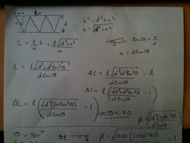

Multipath dispersion is can be solved by:
1) Making the fibre (core) very narrow.
2) By making the cladding which surrounds the core very close to the core refractive index. The closer the two refractive indexes the better as any light that is less than a certain angle will be lost therefore only light that is at the right angle, preferably straight to the optical fibre, reaches the receiver.
