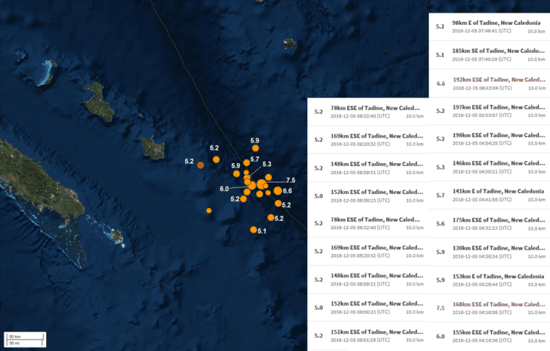

  • Additional posts include a map of earlier aftershocks, with labels provided by a participant.

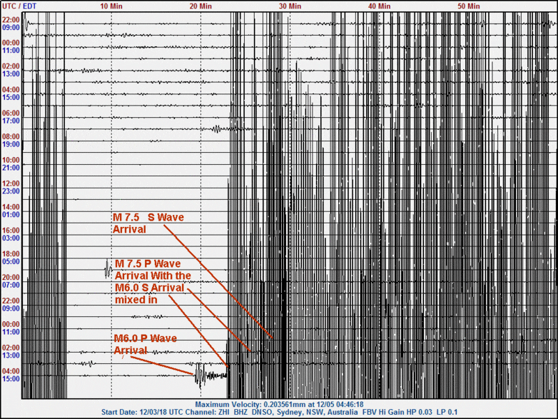

  • A raw seismogram of the Mw 7.5 earthquake is shared, highlighting the P and S wave arrivals.

map of the earlier aftershocks ... I have labelled many of them
Raw seismogram of the M7.5 showing P and S arrivals
