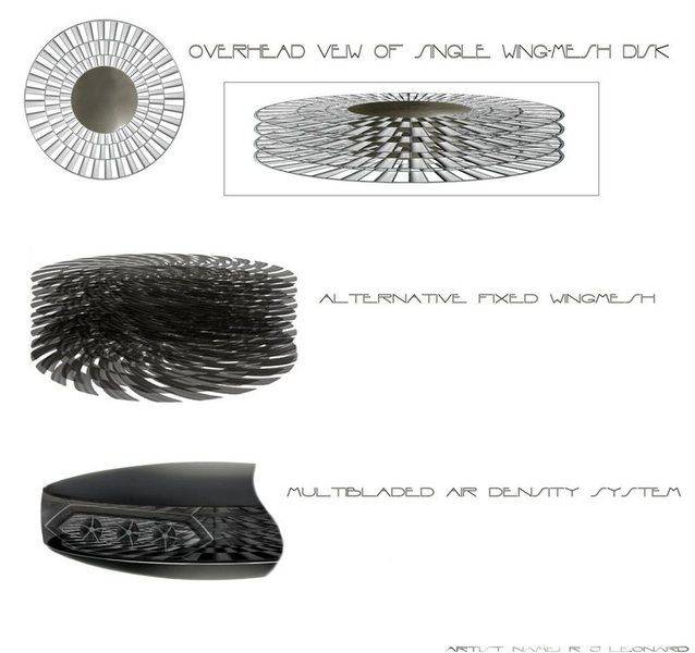

My idea for a flying car...The image below shows my idea for what i call a flyer [flying car/vehicle]. The basic principle is to utilise lift instead of thrust momentum as the means of take-off and flight. This means it won't blow air everywhere and doesn't have dangerous blades [also has safety micro-gauze around wing-mesh], thus providing an improvement to helicopters and a greater diversity of landing potential. The essential idea is simple, if e.g. You tied a small rc plane to a pole by wire, it could take off and land as usual but in circular fashion, so if you had hundreds of them they would do the same. Now add a spoke to connect them to the pole and they would lift en masse as a complete unit. Each disk of wings added together [4X4] would give similar amount of lift to a small light aircraft, where essentially we are rearranging the functionality of such a craft into this form.The vehicle would be mostly composed of artificial black diamond [using my carbon manifestor invention idea [like a 3D printer but not that]] and so is extremely light in weight, and 5 times stronger than the finest steel. The method this version uses is what i call a ‘wing-mesh’ which is a collection of small wings in multiple disks, connected by carbon wires in rings such to provide tilting action akin to take off position for aircraft. A small [non-drive] propeller can be added in front of the oncoming rotation segment of the wing-mesh, so as to create greater air density. A set of multiple small main drive propellers are stationed at the rear of the vehicle and are switched on once the vehicle is say 30ft in the air. they are small so as to provide a smaller thrust vector. The ultra-high-speed motors will have carbonado [black diamond] wires for lightness [instead of copper] and greater rotary speed, this due to the material having 5 times greater conductivity than copper.Ideally as the inventor i would make it very reliable with 3D vision provided by cameras [and emergency parachutes] at the four corners, along with all available detection technology.

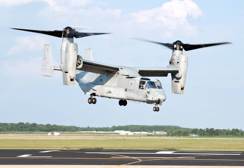

Yes and lockhead have a large annular double rotating wing for vtol... The blog link is closed now so i can't linky to it sry
they are not flying cars though, or anything like. I think my idea is closer?
edit; not in terms of similar usage. you couldn't park it outside your house and take off/land etc with any of those.
With the tilt-rotor concept you can. Especially the versions that fold the tilt-rotor assemblies into the body of the car when on the ground.

No matter how you make lift, you're going to have a large amount of downwash. You've basically just invented a helicopter with enclosed rotors, and your small disk area (and high disk loading) would mean that the downwash velocity would be very high, resulting in a large amount of noise and disturbance to the area beneath the craft. If you want to decrease the downwash from a vertical takeoff and landing vehicle, you need to dramatically decrease the disk loading, which means increasing the diameter of your rotors (a lot).

TBH, I didn't understand what you were trying to say about your blade design. How could it be "far less windy" while producing the same downward thrust? You still need to move the same amount of air to get the same thrust...
Amorphos_b, I think your concept might have a fatal flaw... If I understand correctly, you're claiming to use a set of enclosed "wing-mesh disc" to generate lift, but it cannot generate lift without having net downward air flow like a ducted fan. In your concept you have it enclosed; this would result in the disc's net upward force being canceled by a net downward force of the air hitting the bottom of the enclosure. In other words, it can't work; you'll just mix air in the enclosed space.
Additionally, how realistic do you really think it is to use "artificial black diamond using my carbon manifestor invention"? Sounds pretty out there to me...

Can you tell us about your aerodynamics learning/training? We can try to help you learn, but you should not make assertions that are not backed up by technical knowledge. Wings and propellers are well-understood technologies...
amorphos_b said:
...so i would ask if you think my system would be an upgrade?
Sorry, but no. Stacking rotors on top of each other provides virtually no additional benefit over having just one rotor. There is a reason helicopters have a single, large rotor instead of a stack of smaller rotors: it just works better.

Your concept is not fundamentally different than a ducted fan. I recommend you try reading a little about ducted fans, their design requirements, and their pros/cons.
