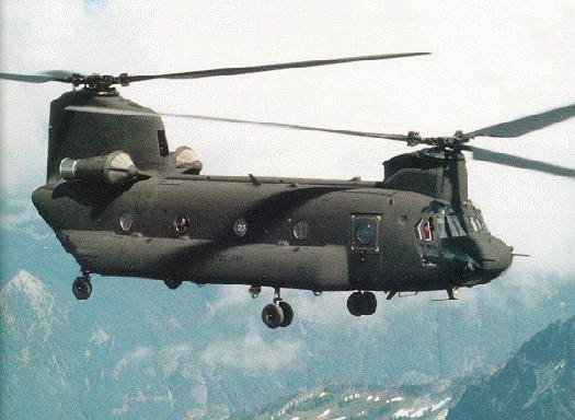

or twin tandem contra-rotating rotors:
Olive-green twin-rotor military helicopter in flight over mountains, with a rear-loading ramp and tandem main rotors.

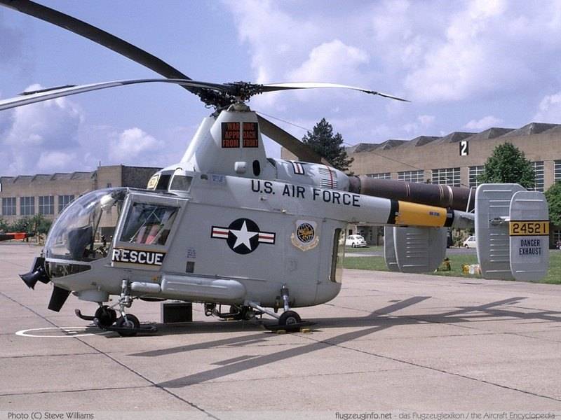

or twin side-by-side contra-rotating rotors:
Photo of a grey U.S. Air Force Kaman HH-43 Huskie rescue helicopter on a tarmac, rotor blades spinning overhead, with 'RESCUE' lettering on the fuselage and a 'DANGER EXHAUST' panel on the tail.

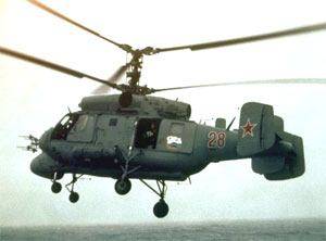

or twin coaxial contra-rotating rotors:
Photo of a grey military helicopter in flight with two counter-rotating main rotors, a red star and the number 28 on the tail boom, and landing gear extended.
I hope I helped!

Can someone explain to me how this works:
Grey U.S. Air Force rescue helicopter with a large two-blade main rotor overhead and a tall rotor mast, parked on a tarmac with the word RESCUE painted on its cockpit door.
My problem is that I can't see how the rotors don't chew each other up.

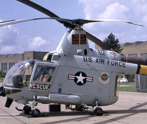

Grey US Air Force Rescue helicopter with tandem rotors on a paved apron, with 'U.S. AIR FORCE' and 'RESCUE' markings and a 'DANGER EXHAUST' panel.
They're synchronized so that the miss each other.
russ_watters said:
just like a baking beater.
exactly!
I think I get it now. I was assuming that one of the beaters would HAVE to hit the vertical portion of the other rotor, but I see now that they each pass OVER the other's center. Very clever.
Thanks
Thanks
You're most welcome.
And one of the great things about that rotor arrangement is that it allows the rear of the fuselage to have clamshell doors which are safe from tail-rotor strike (as there is no tail rotor) for loading of stretcher cases for medevac, or offloading of rescue personnel.
Pretty neat for such a small aircraft!

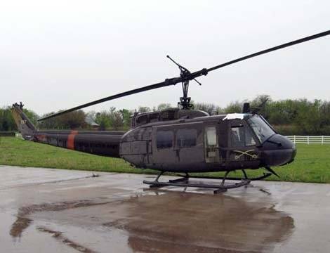

One further means of counteracting the aerodynamic torque generated by the helicopter blades spinning through the air:
a contrarotating coaxial counterweight, which has the advantage of making your tail rotor a much more efficient mechanism of intentional yaw:
(it's the "stick" above and perpendicular to the rotor blades in this photo:
Grey military utility helicopter with a single main rotor and tail rotor, parked on a wet concrete pad with grass and trees behind it.
Photo of a dark olive-green Bell UH-1 Huey utility helicopter with its main rotor blade spanning the frame, sitting on a wet concrete pad on grass with trees behind.
That's just sooo WRONG!
Please delete the post. Someone might actually believe you.
This is a rotor stabilising bar and is not contra-rotating.
You should be sure you know your subject before making such statements.

What concerns me more about this thread is that nonsense about the rotor stabiliser being a contra-rotating mass. I really hope the op will delete it. This lift-thing is an arguable discussion - but this other thing is just wrong! I suppose I should explain what it actually does, but there are too many in this thread that know so much better! :devil:

You're right about the UH-1 post. I no longer stand by it, but can no longer delete it, because too much time appears to have passed since I posted it.
OK, I'm glad you acknowledge the error.
For interest, the reason those masses are there is to balance cyclic loads on the rotor. The loads change as the blades rotate, and when you have just two blades the effects become even more noticeable.
A helicopter rotor works in an interesting way. When a helicopter is moving forwards, one blade is going forwards and one is going backwards. (This is why the speed of a helicopter is limited - eventually one cannot go backwards fast enough to generate any lift at all!)
For both sides to have equal lift, the pitch of the advancing blade is lower than the pitch of the blade going backwards. This balances the L-R lift.. This is achieved by a device called a 'swash plate' that is angled according to the pilots inputs that achieves this oscillating function as the rotor rotates. As these are cyclic variations, that control is called 'the cyclic'. The pitch of the blades can be biased to be greatest either one side or the other, or forwards or backwards. Clearly, if you bias left or right you roll, and f-b you pitch.
To go forwards, you create a pitch by biasing the angle of attack towards the rear of the disc. This would simply cause you to lose height if that was all there was. There is a second pilot control which alters all the pitch angles, at any rotor rotation angle, collectively. This control is therefore called 'the collective'. It moves the whole swash plate up or down, rather than tilting it about its centre like the cyclic.
The rotor balancing shaft helps damp these cyclic blade-pitch variations, and also, so I believe, should therefore ease the loads on the cyclic control.
(I have not flown such helicopters but I seem to recall the stabiliser bar is sometimes dubbed a 'Chinaman's Hat'? Don't take that as a fact unless someone can corroborate it, maybe that was just a 'local' nick-name I over-heard, or mis-heard.)
