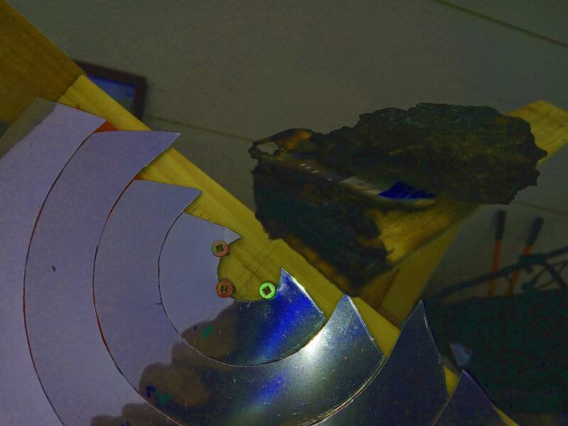

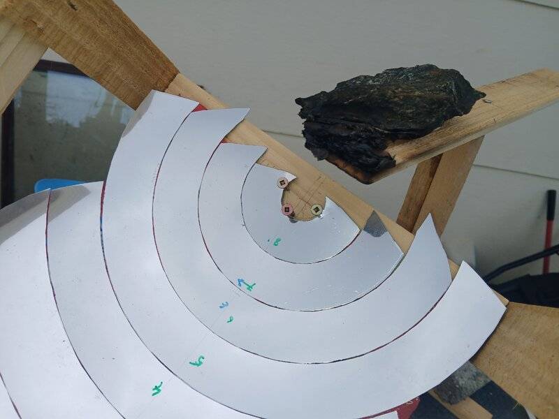

I "designed" this idea over a decade ago but never build a working model. The idea is to make something much simpler and easier to use than typical parabolic dish solar cookers. The biggest issue is that people use the full dish and then it is very easy to get a flash of sunlight in your eyes when you are stirring the pot. This doesn't have that issue.
It's a solar cooker with a reflective parabolic dish on equatorial mount that if it moves at 15 degrees per hour keeps the light focused (more or less) on the same spot all day. The focused spot will be either under a cooking pot or directed into the bottom of a solar dehydrator or solar box cooker. The box cooker will be opened and closed from the back so nobody gets flashes of stray light in their eyes. Same with the pot, I will have to make some sort of shield to protect peoples eyes as they put the pot on and off the hot spot.
This is made for my latitude, 48 degrees north. At the north pole, it would stand vertical and at the equator it would be fully horizontal. (The angle of equatorial mount is the same as your latitude) Anyway, I wasn't expecting it to burn paper or wood so it actually get quite hot.
Last year's tracking solar cooker won a prize on Instructables, but I made it specifically not to get very hot in one spot, and let it be hot all around a big cook pot. Now I realize that this was a mistake. If you get a smaller hot spot and have it on the bottom, you will get more rapid heat transfer. This is like using high voltage versus low voltage.
Anyway, the full scale version will have a reflector about 4 ft by 4 ft. I'm just working out the size now so I can cut it out of a 4 by 8 sheet of chloroplast corrugated plastic without too much waste. I think this would be a great science project for a school.

I made the model to make sure no material was wasted when scaling up. And it was set up very quickly. A few days later, I noticed a glaring mistake in the set up! Hint: it is equatorial mount and it was around April 4th. Can you spot my mistake?

I had adjusted the model down to do the declination, instead of up. So in the demonstration, the spot of heat would have been more concentrated and hotter if I had done it correctly.
