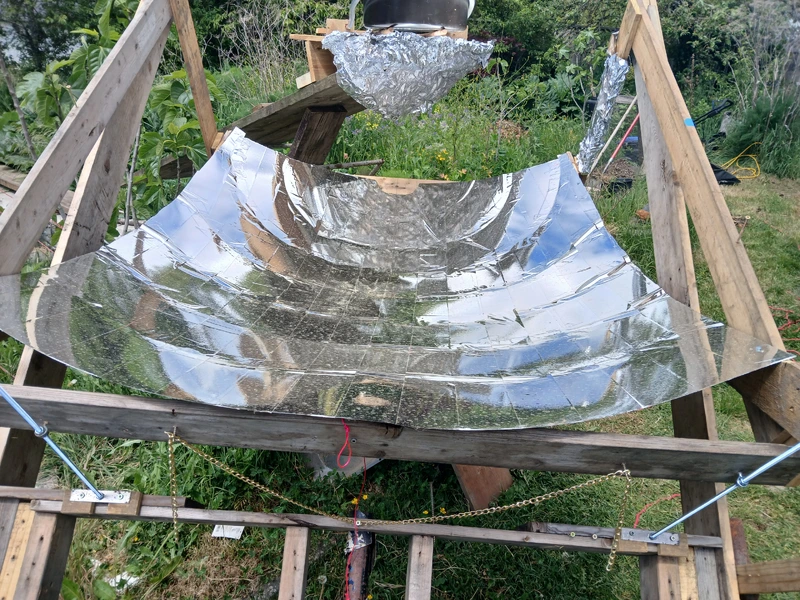

My solar cooker is a DIY proof of concept. Ideally it should be made with a metal frame but I can't do that so it is wood with protective aluminum foil. The idea is to concentrate the light in a 6 inch diameter ball near the bottom of the cooking pot. It is called Sun Scoop because even though it is a part of a paraboloid, it looks like a big scoop.
Wooden-framed solar cooker with a curved, aluminum-foil-covered concentrating reflector, with a foil-wrapped pot mounted above its focal area on a tilted wooden support.
It is on "equatorial mount" that just means it rotates on an axis that points exactly in line with the earths axis. (In my case, that means it is pointing north and tilted up at exactly 48.5 degrees (my latitude). This time of year, I won't be cooking food, there is a lot of sun with clouds, and cloudy spells and days with no sun. So it is not safe unless I do something quick like frying an egg. Instead I steam soil to start seeds in and I steam cut grass to use as mulch. (It rots way quicker when it is steamed and also the steaming kills weed seeds and bugs).

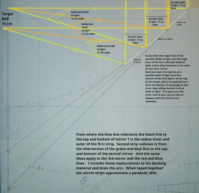

I Went for a 15 cm (about 6 inch) diameter target where all the rays would come together as a ball of light. (I used a 1 to 5 scale so a circle of 15 cm was actually 3 cm wide). I drew a circle of 15 cm diameter for the target, then from the right edge of the target I drew 9 vertical lines 15 cm apart. Between the lines represents 15 cm vertical shafts of light. I then made horizontal lines from the top and bottom of the 15 cm ball. Where the top line intersects the last vertical line and the bottom line intersects the second-last vertical line are the ends of the first "mirror strip" of the parabolic dish.
To get the ends of the next mirror strip, you draw a line from the bottom of the first mirror strip to the top of the target ball, and you draw a parallel line from the bottom of the ball to the 3rd vertical line, Where it intersects the 3rd vertical line is the end of the second mirror strip. You continue with this method until you have your 8 mirrors drawn.
Next you draw a vertical line down from the center of the target ball to the bottom of the page. A line continued from the first mirror strip will intercept that line. Measure its length to both ends of the mirror strip and write them down, do this with all the other mirror strips too. These are the radii of the strips of plastic or metal that you will cut for your reflector!
Hand-drawn ray diagram on graph paper showing parallel light shafts reflecting off mirror strips to converge on a 15 cm target ball at the left, with labels such as Mirror 1 in white and Mirror 2 in white.

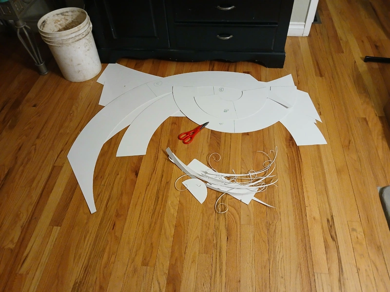

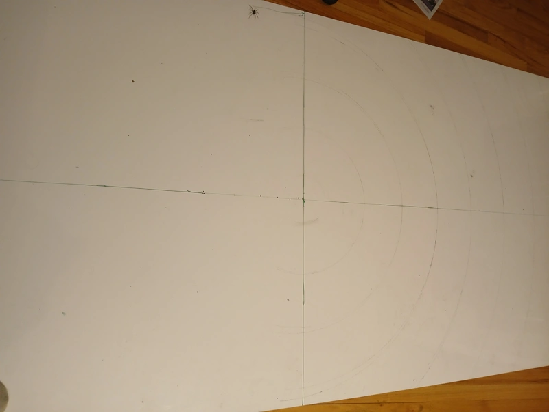

So, I started with the strip for mirror 1 and did its outer and inner radius, I drew the outer radius of mirror strip to the inside edge of mirror 2, then its inner edge, and repeated until I had the 8 mirror strips marked. Then I took a strong
Large white board marked with a pencil cross of perpendicular lines and several concentric arcs drawn across its surface, laid out on a wooden floor.
scissors and cut them out.
I ended up with the strips here and a tiny amount of wasted material, in the little pile at front. Then I used strong construction tape called Tuck Tape to stick them together.

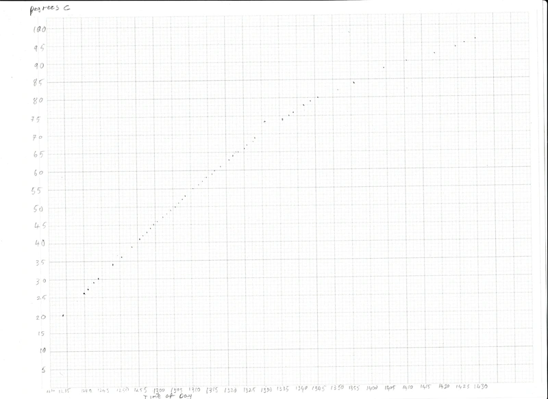

Hi, I have done 3 "boil tests" over the last few months. You heat 10 kg of water to over 90C and measure the speed of heating. First one I didn't have the sun well focused on the pot (pot was too high and I had to rebuild the frame that it was on. Second one, I used a fancy thermometer, but it is FAULTY. It was reading 16 degrees too high! I tried calibrating it against another thermometer but the calibration "line" wasn't straight. So those results were garbage! Last test, even though weather reports were for perfect sunny day, there were some high wispy clouds I used a meat thermometer and it was fine but only measures to 1 degree C accuracy.
But anyway, I took the results. At its best, it delivered 670 Watts to the water. and when it was near the end the water was taking about 215 Watts (meaning that about 455 Watts were being conducted, convected, evaporated and radiated from the pot). I am still using the pot to steam batches of soil and lawn mower chopped weeds. The most I have done in a day is 4 batches. (about 40 liters of soil). I get it up above 90 C all the way through and that is good enough for me.
Last year in a test lettuce seedlings grew roughly 20% faster in cooked soil than in non cooked soil. (I was not adding the chopped up weeds in that test. For me, it is a joy to not have to do weeding and if I sow experimental seeds, there is no guesswork as to which seedlings are weeds and which are veggies.
Anyway, that is the update for now. I have a bit more soil to steam and then I am done. I might do another boil test, and after that, I will make the "solar oven" part, with a "window" at the front, maybe Pyrex, maybe a piece of glass from a microwave turntable. and the door at the back, and start drying fruit and herbs in it. (And I will make it big enough so I can still cook pots of soil in the solar oven). One measurement is faulty, but that is ok, the trend is the thing.
The test was on the 7th July. I would like to point out that 670 Watts is 90% of a horsepower. I don't have to feed my little horse or clean up after it! But the horse only works hard on sunny days. Thanks Brian
Hand-drawn graph on grid paper of temperature in degrees C (vertical, 5 to 100) against time of day (horizontal, 1140 to 1440), with data points rising steadily from about 20 to about 97 degrees C.

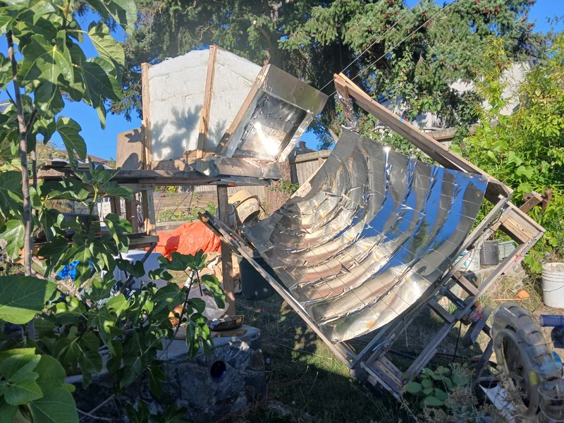

Here it is in dehydrator mode. I am still working things out.
Homemade solar cooker in a garden: a curved, mirror-faced parabolic reflector on a wooden frame concentrates sunlight into a box-shaped cooking chamber above it, with a fig tree in the foreground.

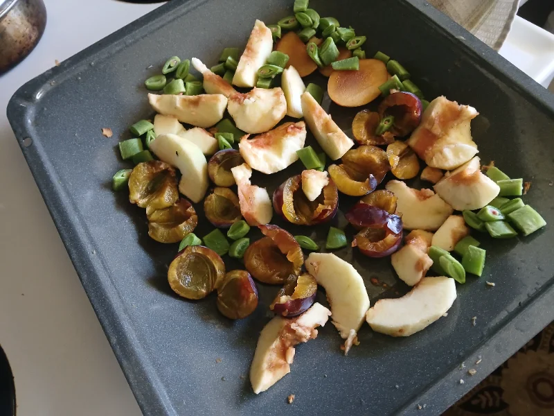

Dark metal tray holding chopped green beans, apple wedges, halved plums and apricot pieces laid out before dehydrating, with some pieces showing browning.
I have been going chunky to dehydrate (saves a lot of fiddling about. In this case, the beans became really tiny, but still were nice, and the plums needed more time. But things didn't last long so I think they were good!
  • Homemade solar cooker in a backyard: a curved parabolic reflector of mirror-like metallic panels on a wooden frame, angled toward a cream-coloured box with a metal-lined interior, with a fig tree in the foreground.

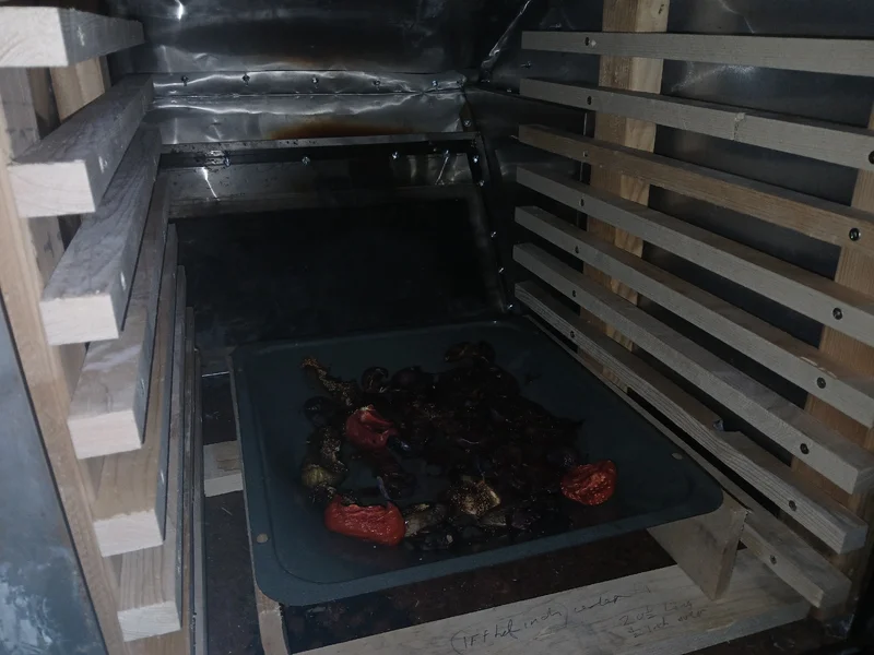

I finally got in supports for large trays today. I have enough stainless steel wire for 4 trays, plus I can use the 2 little trays I already have, so there should be a vast productivity increase! Just have to build those trays! (I think they are 2 to 3 times the area of the trays I already have!)
Interior of a wooden solar dehydrator with slatted shelf supports and a dark plastic tray holding dried vegetable pieces and red tomato halves, with handwritten marker writing on the wooden base.
