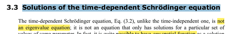

David A. B. Miller's book titled 'Quantum Mechanics for Scientists and Engineers' has an incocsistency
Section 3.3 titled 'Solutions of the time-dependent Schrödinger equation' states in its 1st line that the time-dependent solution is not an eigenvalue equation:
The same section ends with a comment on eigenstates:
How do you reconcile this: are solutions to the time-dependent equation eigenvalue solutions or not?
