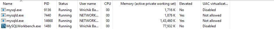

I just installed MySQL Server 8.0. The server is configured to run automatically at startup. However, when I wake up my laptop from hibernation or sleep, sometimes the server stops. I read on the net that I should execute mysqld from command line to start the server.
I have set the folder of binaries in MySQL Server install folder in the path variable. When I execute the above command in PowerShell, I get the following error:
Code:
PS C:\Users\Wrichik Basu> mysqld
2020-05-09T14:06:37.383019Z 0 [System] [MY-010116] [Server] C:\Program Files\MySQL\MySQL Server 8.0\bin\mysqld.exe (mysqld 8.0.20) starting as process 3964
2020-05-09T14:06:37.437373Z 0 [Warning] [MY-010091] [Server] Can't create test file C:\Program Files\MySQL\MySQL Server 8.0\data\mysqld_tmp_file_case_insensitive_test.lower-test
2020-05-09T14:06:37.437616Z 0 [Warning] [MY-010091] [Server] Can't create test file C:\Program Files\MySQL\MySQL Server 8.0\data\mysqld_tmp_file_case_insensitive_test.lower-test
2020-05-09T14:06:37.438002Z 0 [ERROR] [MY-013276] [Server] Failed to set datadir to 'C:\Program Files\MySQL\MySQL Server 8.0\data\' (OS errno: 2 - No such file or directory)
2020-05-09T14:06:37.476711Z 0 [ERROR] [MY-010119] [Server] Aborting
2020-05-09T14:06:37.477010Z 0 [System] [MY-010910] [Server] C:\Program Files\MySQL\MySQL Server 8.0\bin\mysqld.exe: Shutdown complete (mysqld 8.0.20)  MySQL Community Server - GPL.
Taking a hint from line #5, I created the data directory under the path stated in the error message: C:\Program Files\MySQL\MySQL Server 8.0\. Now when I run mysqld, there are no error messages but the server simply doesn't start. So I have to manually go to Services and start the server.
I plan to work from Java using the MySQL J connector. Once the server is up, I can execute commands from Java properly.
Why is mysqld not working?
Note that opening command prompt/PowerShell with administrator privileges does not solve the problem.

But now the mysqld command never stops executing. No errors, no return, nothing. The execution just goes on for hours if I don't terminate it. Perhaps internally it is throwing errors without showing me. Interestingly, however, the server is working fine if I start it from the Services app.
Did you consider permissions required? If services starts the process it has or can get the correct permissions or correct user to invoke the program. Owner!=admin, for example.
  1. Press the Windows key + R to open the Run box, type taskmgr and then hit Enter to launch Task Manager.
  2. Go to the Details tab. ...
  3. Scroll down until you see the Elevated option, check that box and click OK.
  4. Now, the Details tab of Task Manager will be showing a new “Elevated” column.
So you can see what processes including mysqld have special privileges.

Problem persists even if I try to run mysqld from an elevated power shell/command prompt.
