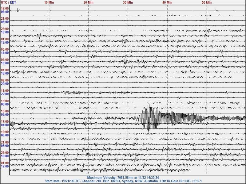

a little similar from my system, just one I have on my work PC
could look through records at home and possibly find a better example :wink:
The P and S waves are very low amplitude but a good surface wave trace ... M5.9 5000+ km from recorderedits to fix image and finish text Dave

you can see in that example of mine, even for a moderate event, the surface waves went on for an hour or so, not just a mere 20 minutes

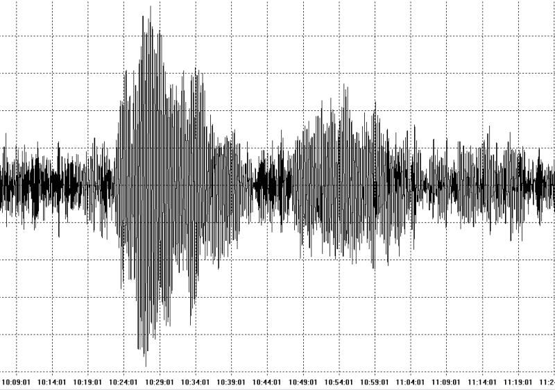

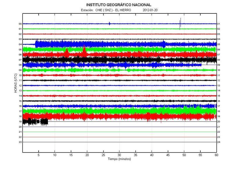

This, of course, has led to lots of wild speculation across the net as to what it was ??
Maybe is it volcanic in origin ? The movement of magma ? tho it doesn't have the appearance of what would usually be termed "harmonic tremor".
Harmonic tremor tends to be more "even" in amplitude with occasional stronger pulses eg ...
4 channels are being recorded here ( 1 colour trace for each channel)
I personally have never seen volcanic harmonic tremor with a smooth drop off of amplitude, producing a nice "bell" shape as in
post #2. Harmonic tremor doesn't produce P and S waves as it is a continuous low level fracturing of rock as magma pushes up towards the surface.
