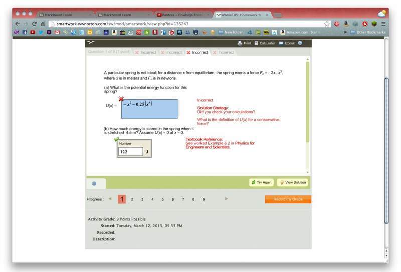

I took the integral of the equation but its wrong, the program does not have a fraction input to put 1/4 properly. I ended up with -x^-1/4(x^4).
For part b I plugged in 4.5 and turned the number positive to get the answer.
Did I do something wrong for part a?
That you had to turn the number positive should ring a bell.
If I plugged in 4.5 into the antiderivative then it would be -122 and that's not correct
What is the relationship between F and U?
F=U/x
You need a review on that.
force is the derivative of potential energy which means the antiderivative of force is potential energy
That's not exactly correct. Why do you think you had to massage the sign to make the ends meet?
is it because U(x)=0
Stop guessing. Get your textbook, and find out how potential energy and force are related.
F=-dU/dx
but when I put in x^2+1/4x^4 or -(-x^2-1/4^4) it is still wrong
For F(x) = -2x - x^3, U(x) = x^2 + (x^4)/4 is correct. I do not know why it is not accepted. Perhaps there is some particular way you should enter it.
when I input that it says ''this is not a definite integral''
