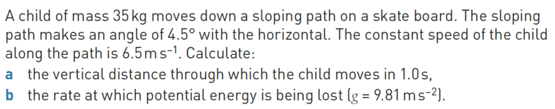

Please see below
PE = mgh
I got answer for (a), which is 0.51 m
For (b), loss of potential energy = 35 x 9.81 x 0.51 = 175 J
Rate of loss of potential energy = 175 J / 1 s = 175 W
But the answer key is 80 W. Where is my mistake?
Thanks
I think your answer of 175 W is correct.

If one were adhering to the rules of significant figures, your 175 W (175.103048... on my calculator) would round up to 180 W.
Is it possible that the answer key says "180 W" instead of "80 W"?

Maybe it is a typo, the answer is written 80 W.
