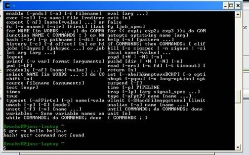

Cygwin is telling me that it doesn't recognize the command "gcc"
Perhaps I didn't include the proper packages when installing? I simply accepted the settings that it included, not knowing what was what.
Also, how do you specify the directory that your C program is stored in?
Thanks.

Hmm... I was 99% sure that Cygwin included gcc by default. Try g++ instead:
g++ -o hello hello.c
- Warren
Thanks.
You probably need to rerun the cygwin setup program to select gcc. Once it's installed and you're in the cygwin shell, it should already be in your path. However, it won't work if you try to run it from a regular windows console.
