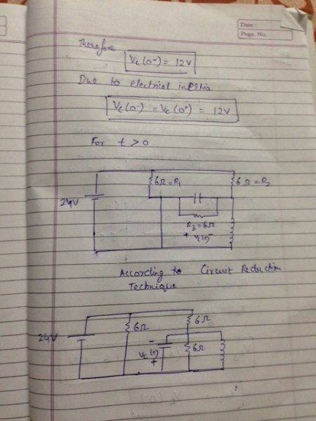

Your V(0+) and V(0-) are wrong. Hint: check sign on Vc(0+). Vc(0-) should be obvious. I assume by Vc is meant the right-hand side of C. If by "V(0+)" and "V(0-)" you just mean the voltage across C then you're OK.

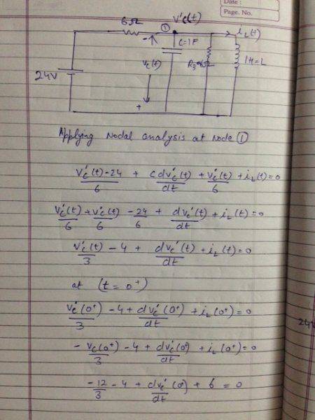

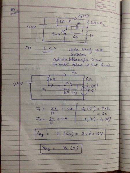

I am sorry. I should have used "I think". I solved the problem roughly using general equation of voltage across capacitor Vc(t)=Vc(final)+[Vc(initial) - Vc(final)]e-t/RC. But after your reduced circuit i solved it in the following manner as per given in figures attached.

rude man said:
As usual I can't make out people's writings. But if you still got dvc/dt = -2V/s. that is clearly incorrect. At t = 0+ there is a step change in Vc and the derivative of a step is the delta function which is infini
Vc is marked on the schematic as the voltage across the capacitor plates, by essentially a left-pointing arrow.
Vc(0-) = Vc(0+) = +12V
Immediately the switch is thrown, the current into the capacitor changes from 0 to 2A to the RHS plate, this equates to
dVc(0) /dt = -2 V/s
dVc(0) /dt = -2 V/s
Yes. I was computing the voltge at the right-hand node. Either didn't see the vc as marked or it was added later.
Are you doing the rest? The OP seems to have gone AWOL.
