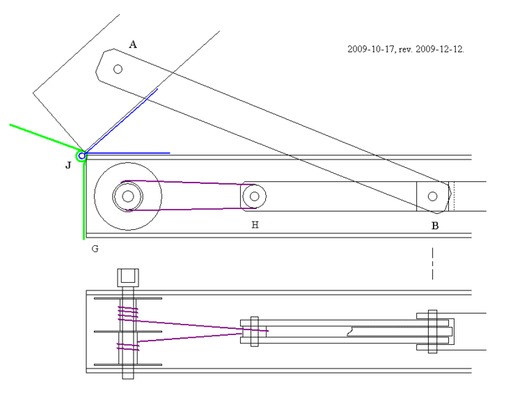

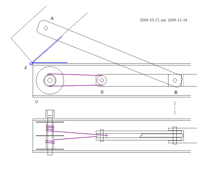

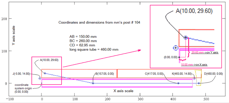

Nice video! I see how this mechanism that you provide in post #14 works and functions do to this video.
I see as the left short tube position opens ''point A'' rotates as it pulls torwards ''point C'' as the right side pushes up on the opposite side to lift the shorter tube on the right side as the process reverse to pull torwards ''point A'' went it closes.
At frist in your #14 post I didn't noticed that linkage rod A is longer then linkage C and how A and C positions are mounted high and low above and below the hinges knuckle to give the leverage to lift each side.
How would you attach a motor to this mechecnism or would you have to modified or change the complete design for this mechanism design to function.
Is there a way to show me this in a video. That if you could.
P>S How did you make that video to have that move like it dose If you can explain.
Thanks.

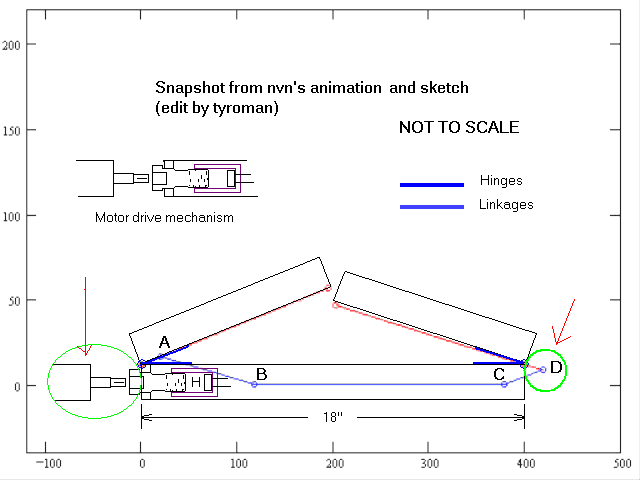

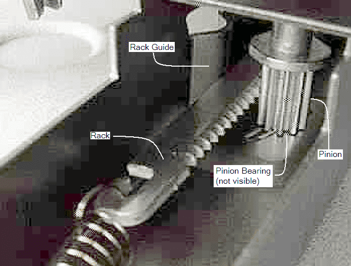

I understand what you are stating in post 58
I could lift up the tube to 3/4'' as stated with another piece and maybe to 1'' BUt 1'' that the maximum do to the low point where the door sits low form the top of the longer 1'' tube.The door thickness is only 3/4'' and 1/2 of that sits inside the entrance hole I will have to add a vertical piece to the top of the shorter tube and bend it to account for the diffrence in height but that's not a problem if I don't go higher then 1'' under the long tube.
So your saying the rack and pinion Can't be higher then the closed shorter tubes if that's the case then the plate mentioned in the last few post dose have to be higher the shorter tubes either. correct!
The counterweight reducer will be a spring in reducing the weight of the doors if that's the case the motor will easily lift the door even through it could lift 40lbs.
As to the 41lbs of force if that's the total force of both doors as you mentioned then a 20lb spring would be use to low the force on the mass which is the door. Correct!
Yes 1'' from the hinge and lifting the 10lb 1'' high will have the greatest force on the mechanism to lift the lid in motion,this is where the spring comes into play by lowering the force on the center point of the door and hinge and its mass so the torque on the motor is lowed. Correct!
As for your sketch this is what i understood. If I'm wrong please explain.

cybertron: The mechanism I designed is independent of an optional motor. A motor could assist, but is not required for the post 14 mechanism to work. You could attach a motor anywhere you like, as you see fit, if you wish. I will try to leave that up to you.
  • #66
nvn
Yes the mechanism designed in post 14 dose require a motor to work; I see that.
I do want to add a motor to that mechanism and it would be attached to point (A)
on the short tube would there be a way to attach a gearmotor from the woodenbase in the space that i have to point (A) so it functions like in post 14, but with a motor.
any further help would be appreicated.

I added 1-1/2'' spacer under the longer tube to accommodate for the function and strenght of the rack and pinion. Thats the maximum height allowed. Do to adding that spacer to 1-1/2'' I will have to add a vertical bend piece of tubing to the shorter tube to the door because the door will sit at the lowest point of the 3'' height of the tubing.That not a major problem to change.

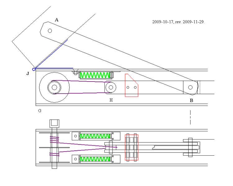

Can you tell me what is the part outlined in red is, is it a standard complete part i could buy,or 3 separate parts and how is this connected to the tube. I'am assuming that the rods are rounded or flat in your image.
Ha is there a way to make a video out of this image.
that last video was nice. I keep watching it. how was it made.

I now revised the attached file in post 68; see the revised file. The linkage bars in the post 68 diagram are flat bars, not round rods. The purple sleeve (cup) is a separate part. It is a solid square bar, then you tap a blind hole along its centerline. The bottom of the cup has a rectangular hole, through which you insert linkage bar HB. Linkage bar HB must be free to slide to the left. I.e., linkage bar HB is not rigidly connected to the purple sleeve at H. I don't know if "linear motion" equipment manufacturers, etc., might have something like the purple sleeve you could buy. You will need to research all available parts and manufacturers on-line. If not available, then you can hire someone to machine some parts. No problem.

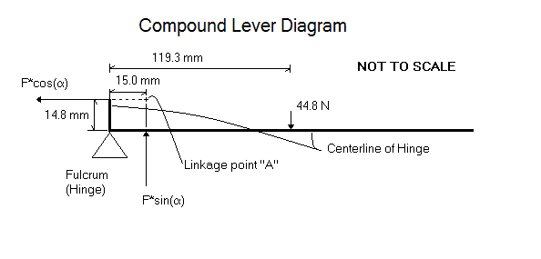

Now, for the question of how much force the motor and mechanism will need to deliver:
Look again at the sketch I attached to post #59. The force necessary to start opening one of the doors with the mechanism is represented by the arrow labled "total force on linkage". You will see that it is much longer than the line representing ~41 pounds. I have not calculated that force (it will depend on the final configuration of the mechanism and the size of the angle "theta" shown on the sketch), but I would expect it to be in the range of 100 pounds.
Since the motor will be moving BOTH doors at the same time, it will need to deliver twice the force; or about 200 pounds. Any spring or counterbalance system should be set up to make the effective weight of the doors as small as possible.

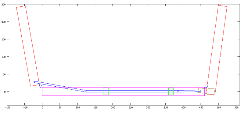

On linux, you can use octave, gnuplot, and ffmpeg. I don't know the details of how it works, since I didn't set it up; and I wouldn't have time to go into that. I don't know if it works on Windows or Macintosh.
cybertron, you will be the one who needs to do most of the on-line research to locate off-the-shelf parts, unless someone else here happens to find some parts for you. Also, I think there are individual machinists who will do small jobs. So don't give up before you have tried to contact them.

In post 68 in the drawing what is that part in the low bottom right.please explain.

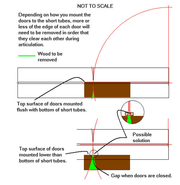

If you can Picture two leaf style cellar doors that open from hortizonal to vertical there should be nothing blocking that area to enter.

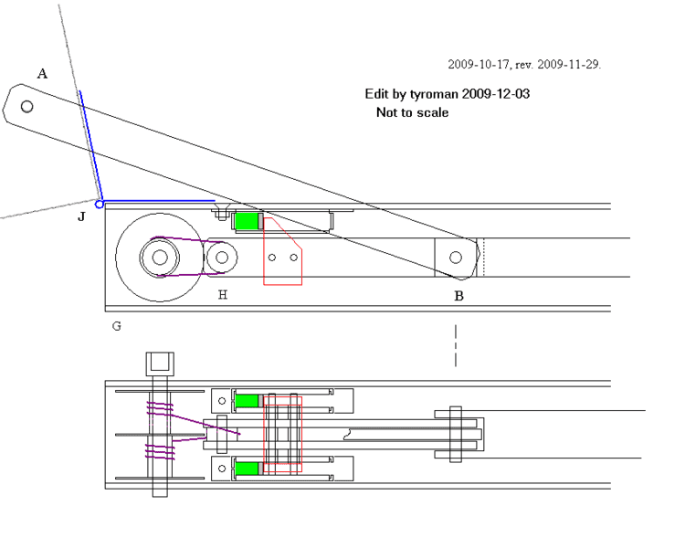

I edit post 71 to show you what the top view would look like if you were looking down at the two door.
As you can see you have the tubular lifter than the mechanism then the left-over space which would now be 1-1/4'' from the mechanism to the wall.
As stated in post 53 and 80.
The pink area ENDS where the tube lifter begins.As indicated in edit image.

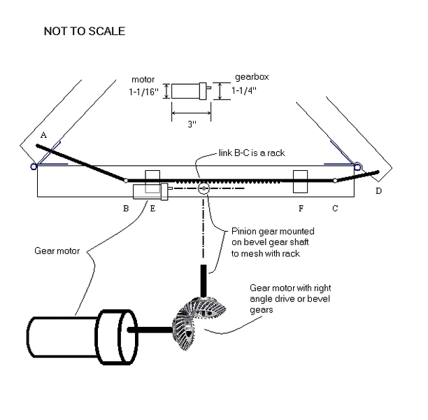

I think it is less important to cybertron that the doors move "exactly" in unison than it is that the motion of the mechanism begins with both doors at 0 degrees and ends with them in a 90 to 100 degree position... can you find a way to position the A and D connections and adjust the length of links A-B, B-C and C-D to make this work? Perhaps have the A and/or D connection(s) made at a "crank" attached to the short tubes (see attached "nvn's links.PNG" sketch).
Also, since cybertron's earlier clarification that the mechanism does not have to be "inside" the long tube and that the long tube will be installed "with a 1-1/2'' spacer under the tube", there is more vertical room to position your mechanism if you attach it to the side of the long tube rather than inside.
Mounting the motor as you have described (off the end of the long tube) may be unacceptable to cybertron (based on the 2"x18" work space)... but I think this can be solved with your design if the motor is connected to a right-angle drive
see:
http://www.torquetrans.com/right-angle-gear-boxes/miniature-right-angle-drive.htm
http://www.torquetrans.com/right-angle-gear-boxes/images/ra202_figure_1.jpg
or bevel gear:
http://www.qtcgears.com/KHK/newgears/KHK230.html
which is then connected to a pinion mounted on the side of the long tube. The pinion would mesh with teeth on the edge of your link B-C (which would be made from a rack of appropriate length). See sketch "door-mechanism-05 (with motor).png" attached. This would also be the way to motorize the double rack and pinion design if that is the way cybertron decides to go.
Again, I believe your design will be stronger and simpler than the double rack and pinion design... if we can make yours work.

tyroman: I tried about ten different ways, so far, and could not get both doors to end in the range 90 to 100 deg. But I will continue trying all of your new suggestions (or any others you may think of) over the next several days, to see if I finally get lucky and find a combination that works. I'll let you know as soon as (if) I find something that works.

In post you also showed nvn in the first image how the door are attached to the short tubes,They are not attached there.
The two doors sit at the 1-1/2'' spacer level sits. I did not indicate at all that the doors would sit on top of the shorter tubes nothing can go on top of the shorther tubes,But There will be a bend piece of metal that will be attached to the top of the shorter tubes bend at a 90dg angle then 3'' down then bend at another 90dg angle then attached to both doors. I stated this in my post in 67. The two doors sit at the wooden base level,not on top of the shorter tubes.I showed you in post 82 how the tube would look from a top view. Because the two doors sit at the woodenbase level or floor level. I did state in post 67 that a piece of bend metal will accommodate for the 3'' heigth difference do to where the two doors sit. They do not sit on top of the shorter tubes.

Ok, So the concept for that propose mechanism in post 14 will not work at all, what was the reasons for not getting the doors to 90dgs,was it the limited space or other factors of the design. And using an optional motor.
As for a symmetic design will this concept work, and will it work in such a small area with the optional motor as mentioned.
  • #88
The main reason the post 14 concept does not work is due to the asymmetric mechanism geometry.
I have not worked on a symmetric design much, myself (except for posts 7 and 10).
  • #89
Tyroman
Is your mechanism design concept a asymmetric as nvn concept in post 14 or is your concept symmetric as nvn proposes that a symmetric design will be needed.
Will your concept as proposed work also.

nvn said:
What about something like this? Not to scale.
nvn
In this design concept as proposed in post 10 is there a way for this to work in the small limited space that i have and using my motor that's been mentioned in this thread with the concepts that already been stated and suggested by you as well as tyroman suggested with right angle gears and rack parts.Is there any other combinations that you could come up with in this concept that can work in my project do to the limited space and geometryand getting the doors to open and close at 0-90dgs.
In post 67 i increased the height with a 1-1/2'' spacer to compensate for the rack and pinion that tyroman advised,So I have now about 3'' from the wooden base to the top of the shorter tube to give some more height to the area.
I hope you have not given up on me just yet! But i do Apperciate all the time you have given to me on the mechanism design and to this thread.
