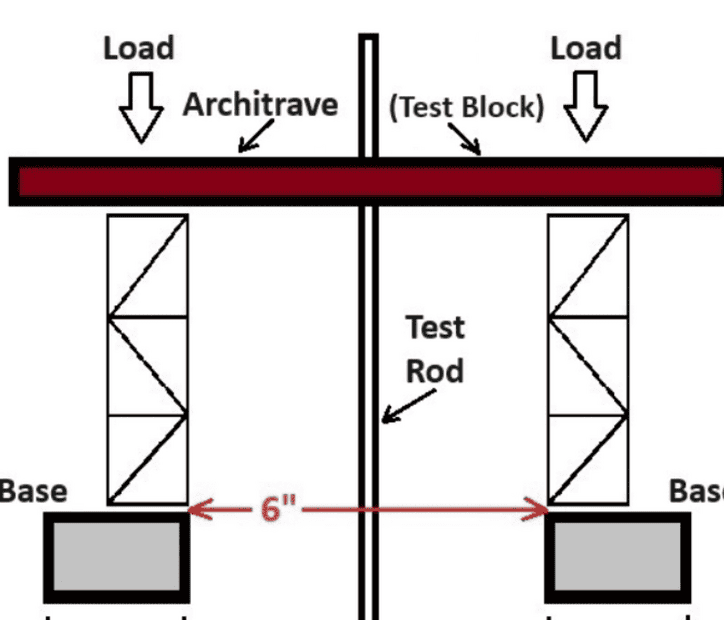

Here are the specifications for this competition:
-2 TOWERS
Length: 1-1.5”
Width: 1-1.5”
-Height: 7-8”
-The architrave/test block will sit on top of these two towers, being 10” long, 2” wide and ¾”
thick.
-1/8x1/8 balsa wood must be used (Max 16 linear feet)

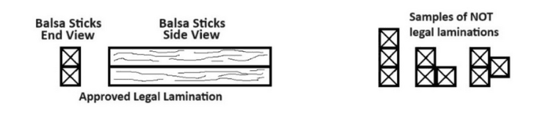

-Single lamination is permitted with two pieces of balsa (Im wondering if I should use this on the verticals)
-Lap joints are allowed

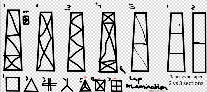

I have developed some designs and am looking for feedback on them. Which do you think I should use for testing? I am open to harsh critiques. For most of the designs, I would probably use lap joints. I think I would also use a taper and 2 sections to save wood, how do you feel about this? The bottom designs are from a top view, I came up with some cool designs that I think could be strong, such as the upside-down y, but I'm not sure how I would build it if someone could help me with that (The angels wouldn't line up how would I put a rectangular stick in 3 directions of the middle one).
I also think a triangle could be strong, but I am not sure I would build it.
I could also use lamination in the triangle.
Are there any other designs that you think could be stronger? Please help me out if you have the time! Do you think some creative designs like a + shape could outperform a basic square?

How are the length and width measured?
Does the tower have to be rectangular in all dimensions?
What stops the test rig from rotating?
Can the tower be spindle-shaped, with a small flat area at each end? It would want to bulge out more in the middle.
Can the tower be a hyperboloid, made from straight lines, with a circular base and circular crown. That way, given solid end rings, it all holds together against itself.
https://en.wikipedia.org/wiki/Hyperboloid_structure
You must allocate the available limited resource to where it is most needed.

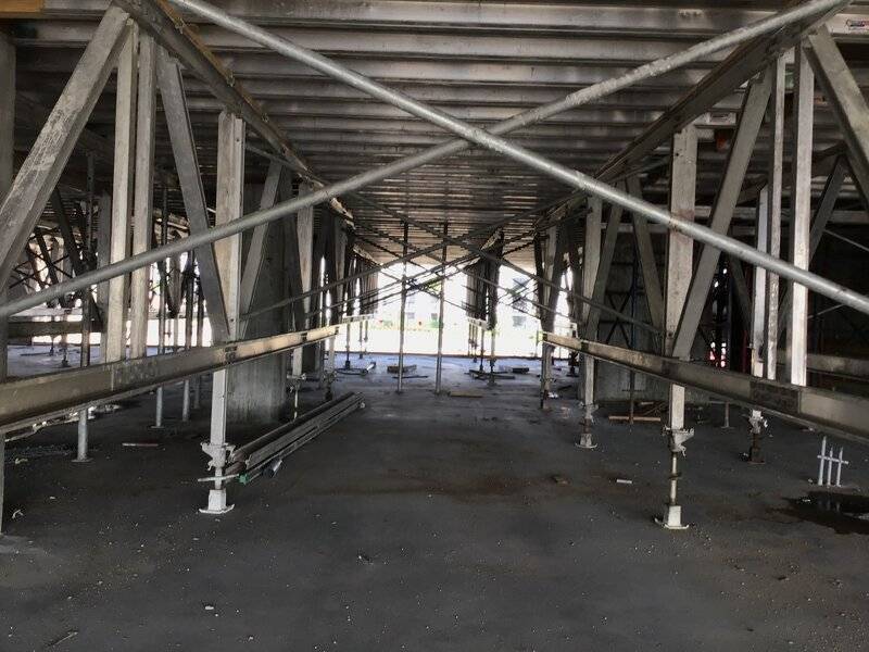

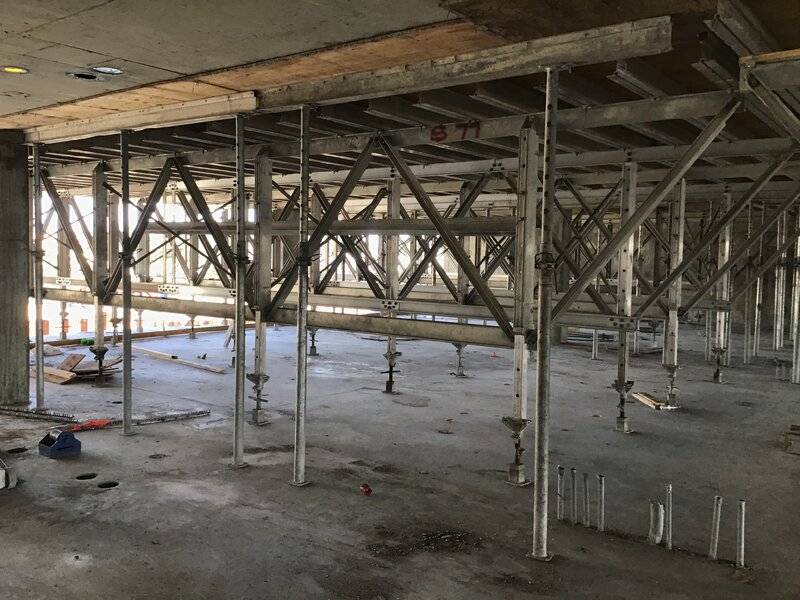

Welcome, @curiousgoose !
Observe the structure that the below pictures show.
The purpose of that temporary structural device is to support the weight of a 8-inch thick concrete while being poured to form one of the floor's slab of a multistory hotel.
Therefore is basically compressed by weight between two horizontal surfaces.
We can then discuss the function of the different elements of that armature.
