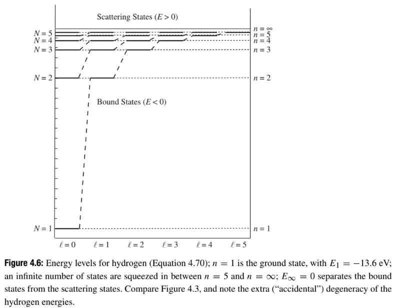

Here is another figure from page 149, but I found an equation to relate ##N,n,l## in this case: ##n= N +l##
But it is not the case that ##n= N +l##
There can be no comparison here. The infinite spherical potential is not the same as Coulomb potential. The radial wavefunctions are completely different.

In the case of the second image, what is ##N## and what is ##l##? Is it still the case that ##n## is the principle quantum number, which simply orders the allowed energies?
I don't have that figure in my edition. I don't know what ##N## represents; read Griffiths and see how he defined it. You can see from the figure that here ##N=n## in other words the ordering of the energy levels is independent of the value of ##l## and ##N## is the same as the principal quantum number. You knew that already (I hope) because the energy levels for the hydrogen atom are given by ##E_n=-\dfrac{13.6~\text{eV}}{n^2}.##
I think I get it.
For instance if ##n=2##, then from ##n = N + l## we have either ##N = 2, l = 0## or ##N = 1, l = 1##. These match the bound states on the horizontal line marked ##n= 2##.
If ##n=3## then we have ##N = 1, l = 2##, ##N = 2, l = 1## or ##N = 3, l = 0## Again, these match the bound states on the horizontal line marked ##n=3##
