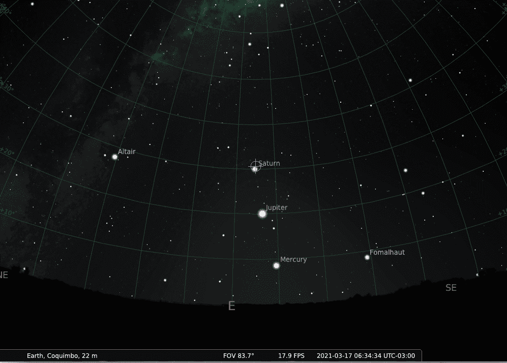

By the way, am I right that using this stellarium, you can tell me in what time and in what dirrection to watch to see something? It is amazing. Many many thanks to all of you.
Yes. Here's an example screenshot from last week. You tell it where you are and what time it is, and then you can pan around looking in different directions. Planets and birght stars are labeled, and you can get more information on other objects by clicking on them

One important thing about Stellarium is that it doesn't suggest what to look at or when interesting things will happen. It's more of a good tool than an 'instructor'. You need to find and look at local astro society websites and they tend to tell you 'object of the month' etc. Stellarium will then point you at it. (You use the Find facility).
The pop up bar at the bottom gives you several tools - for instance you can advance the time and see things move across the sky as time goes by.

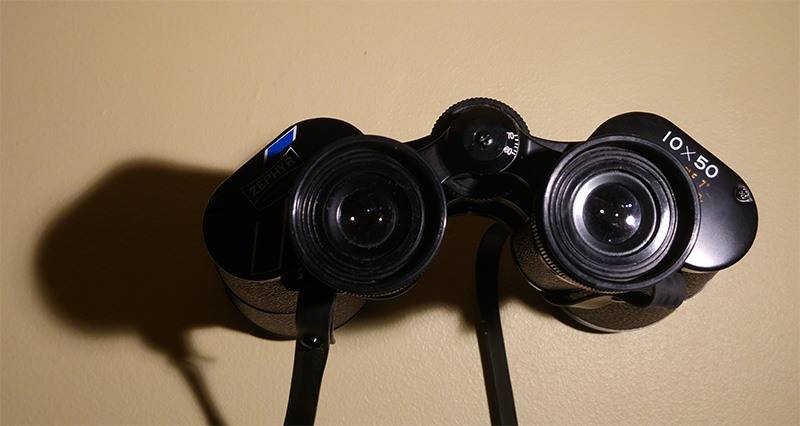

I just tried all my binoculars and monoculars on the nearly full Moon tonight:
Zephyr 10 x 50 vintage binoculars
Bought: Cheaply at a second hand store (about $30 if I remember correctly).
Result: Good view

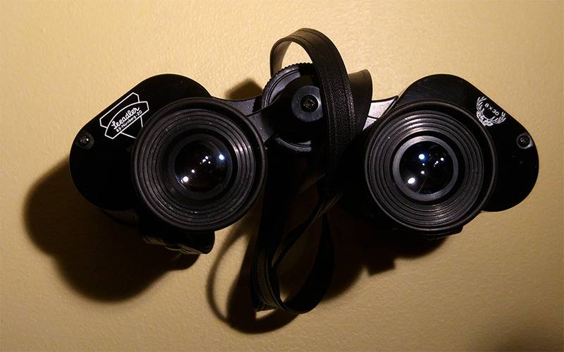

Seeadler 8 x 30 vintage binoculars
Bought: By my father, and later given to me.
Result: Good view

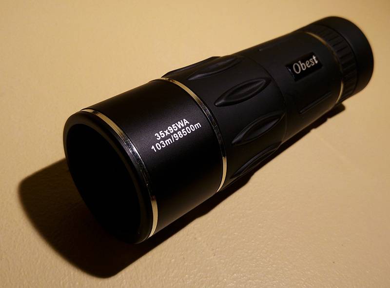

Obest 35 x 95 monocular
Bought: Cheap from China.
Result: Good view

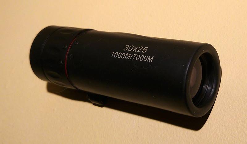

"Noname" 30 x 25 monocular (I don't remember the brand)
Result: Ok view

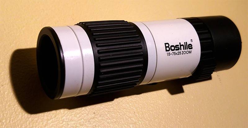

Boshile 15-75 x 25 zoomable monocular
Result: Useless
This is a faulty item; it produces "double images" so it's useless.
It's a pity, since it's a pretty cool little gadget which is zoomable,
i.e. it offers different magnifications. It looks like it could
produce a rather good view, so I may try to fix it someday.
Summary:
I'd say the Obest monocular gives as good view as the Seeadler binoculars.
The Zephyr binoculars are slightly better. They are thus the best of these.

Result: Ok view
If you are happy then that's the main thing but assessing and comparing optical instruments should really include some specific criteria. For instance, how well can a particular double star be resolved or how badly does the nearby Moon affect what you see? Once you get really fussy, it's contrast that will often let you down and the 'blooming' on the objective will have a big effect. Some cheap binoculars, with claims of good performance, will often have a Red caste on the objective, which means there's a filter which cuts the shorter wavelengths and that will affect the Magnitude of stars that you can actually see.
Not uncommon and can be caused by multiple reflections in the Prism system and faulty colimation (Colimation can be even worse in binoculars, of course). Zoom devices tend to sacrifice quality for a given price. This is true for camera lenses although top end zooms are pretty damn good. Better results are usually obtained with primary lenses but cropping an image can take you back to the image quality of a zoom lens.Edit: Playing for sympathy here but, as I get older, the limit tends to be my eyesight. It's not the prescription and I keep it regularly up to date. The problem is firstly a hint of cataract in both eyes; that messes with the contrast and then the limited diameter of the pupils (happens to all older people) and that limits the effectiveness of a wide objective lens; 50mm is a bit wasted on me, compared with a fit young whippersnapper. Grrrr.
