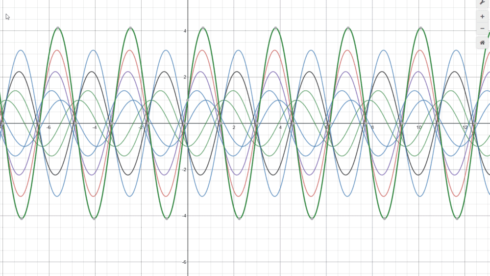

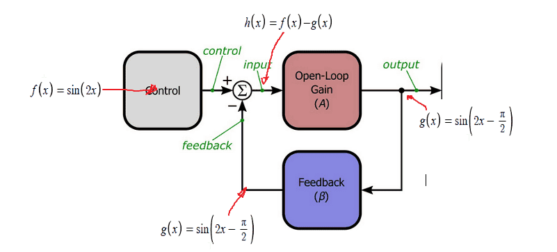

Trying to make sense of the stability of a negative feedback.

Most important: Show the following three functions in one diagram: f(x), g(x) and h(x)=f(x)-g(x),
Starting with the calculation for h1 you actually apply a phase lag of 180 degrees. The period of the signal is π so h(x-π/2) will lag h(x) by half a period.
What is the proper way of doing it then? Isn't the difference f(x)-g(x) supposed to be delayed by 90 deg when it passes the loop?
The open loop gain term A does not appear in your equations.
The open loop gain of the amplifier should be very high.
The loss and the phase shift in the feedback loop should be low for low frequencies.
The amplifier is an op-amp, the output changes, hopefully to make the inputs equal.
The feedback gain above the frequency where 180° phase shift occurs must be less than 1/A. You should only test with frequencies below that frequency.
If you want that, you should use a delay of a quarter of the full period, so you must use h1(x) = h(x-π/4). Your calculation of g(x) is still correct because sin (2x - π/2) = sin (2 (x-π/4)) so you have the correct delay there.

paulmdrdo said:
Summary:: Trying to make sense of the stability of a negative feedback
I don’t think the math in the image is correct which might be why you’re confused.
The output of the open gain amp should be Ah(x) but it is drawn as g(x) which means the f(x) term was dropped.
Also, one can definitely analyze this structure with math but to do this analysis you need to define what definition of “stability“ you’re using. There are options.
The usual solution is:
Ah(x)=g(x)
A(f(x)-Bg(x))=g(x)
Af(x)=(1+AB)g(x)
(1/(1/A)+B))f(x)=g(x), giving the output in terms of the input
In your example A and B are not equal to 1. They are an all pass filter with constant phase delay.
