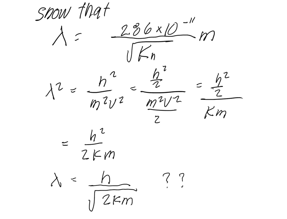

Show that the wavelength of a neutron is (2.86x10-11/√K)m where K is the kinetic energy in electron volts.
λ=h/mv
λ^2=h^2/m^2v^2
=h^2/2/(m^2v^2/2)
=h^2/2/(Km)
=h^2/2Km

There are 2 brackets missing in the homework statement. They look OK to me in the attempted solution. I can't get to the answer (λ in terms of K and m) from my last line. m should be in the numerator.

No, numerator is correct. Actually, when I looked again at the homework statement, the brackets are OK.

The mass in the numerator is not correct.
##K=\dfrac{p^2}{2m}~\Rightarrow~p=\sqrt{2mK}##.
##\lambda=\dfrac{h}{p}=\dfrac{h}{\sqrt{2mK}}.##
