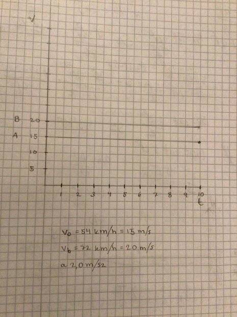

I did a v-t-graph. But I get lost on what to do when it’s starts to accelerate at 10 seconds. This is what I’ve done so far. Any suggestions on how I can move forward?

At t = 10 s car A acquires an acceleration of 2 ##\frac{\text{m/s}}{\text{s}}.## This means that every second that goes by, 2 m/s are added to the speed that is already there. Some folks call acceleration "the speed of the speed" because it tells us how fast the speed is changing just like speed tells us how fast the position is changing.
Does this help with what to do next?

Yes, makes sense. It’s just that I don’t know how to tilt the line to get the proper answer in my graph. The reason I’m doing it is because I think I’ll understand it better once I can see it visually.
Like I said, make a table. At t = 11 s the speed has increased to what value? Draw a dot at that value on the graph. At t = 12 s the speed has increased by 2 m/s from the value it had at 11 s. Put another dot on your graph at that new value. Keep going this way. After putting down a few values in your table and your graph, use a ruler to connect the dots.

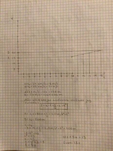

Okay, so this is what I did and I got the answer 15 s. I’m not fully sure if the answer is right so do you know if I’ve done everything correctly?

You did a velocity vs time graph and found the car that accelerates has the same speed as the other car after 15 s. Does that mean they are at the same place?
One important piece of information is that when you draw a v vs. t graph, the area under the curve is the displacement of the moving object. Look at your graph.
From t = 0 to t = 10 s
The area under the A curve is that of a rectangle of height 15 m/s and width 10 s.
The displacement of car A from 0 to 10 s is (15 m/s)×(10 s) = 150 m. You called that d_1 in post #1.
The area under the B curve is that of a rectangle of height 20 m/s and width 10 s.
The displacement of car B from 0 to 10 s is (20 m/s)×(10 s) = 200 m. You called that d_2 in post #1.
The difference in distance between the two cars is the difference of the areas between the two rectangles and you called that d_3. So far so good.
For car A to catch up with car B the areas under each curve must be equal. Now look at the graph from 10 to 15 seconds. The additional displacement of car B is a rectangle while the additional displacement of car A is a triangle.
What fraction of B's displacement is A's displacement?
Can you extrapolate at what time t_f the area under the triangle from 10 s to t_f will be equal to the area under the rectangle over the same time interval?

Hi @Syw. The graph in your Post #20 attachment (here) shows car A accelerating from
15m/s at t=10s
to
20m/s at t=15s.
This is an acceleration of
##\frac {\Delta v}{\Delta t} = \frac {20m/s – 15m/s}{20s - 15s} = \frac {5m/s}{5s} = 1 m/s^2##
But A’s acceleration is supposed to be ##2 m/s^2##. So the graph is incorrect.
