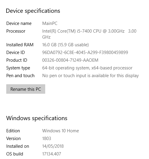

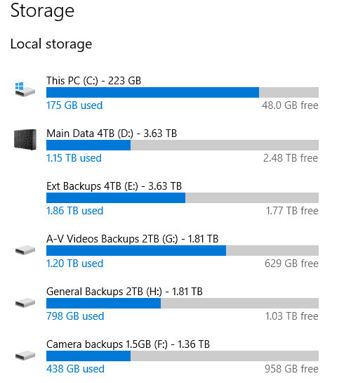

I have been building my own PC's since 1990 when I built my 286 which in those days the math co-processor was a separate device
It has been a great learning experience as the technology improved and the prices dropped over the last 30 yrs
I'm a real fan of the Gigabyte motherboards, they have been the core of my last 3 home main PCs
and a crap load of storage
somewhere around 12 to 13TB

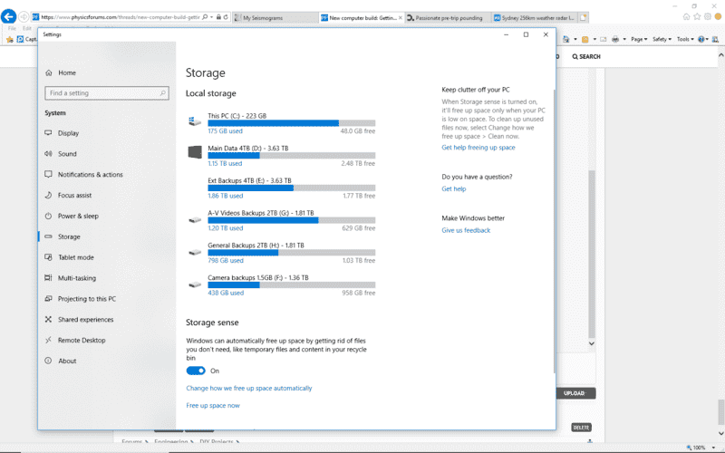

One important change I did with this PC, when I built it earlier this year, was to keep programs separate from data
All programs are installed on that "This PC C:" drive which is a SSD ( Solid State Drive) Sata ... very fast !
and I don't block it up with data ... it gets spread across the other drives depending on topic etc
I highly recommend this approach :smile:Dave
