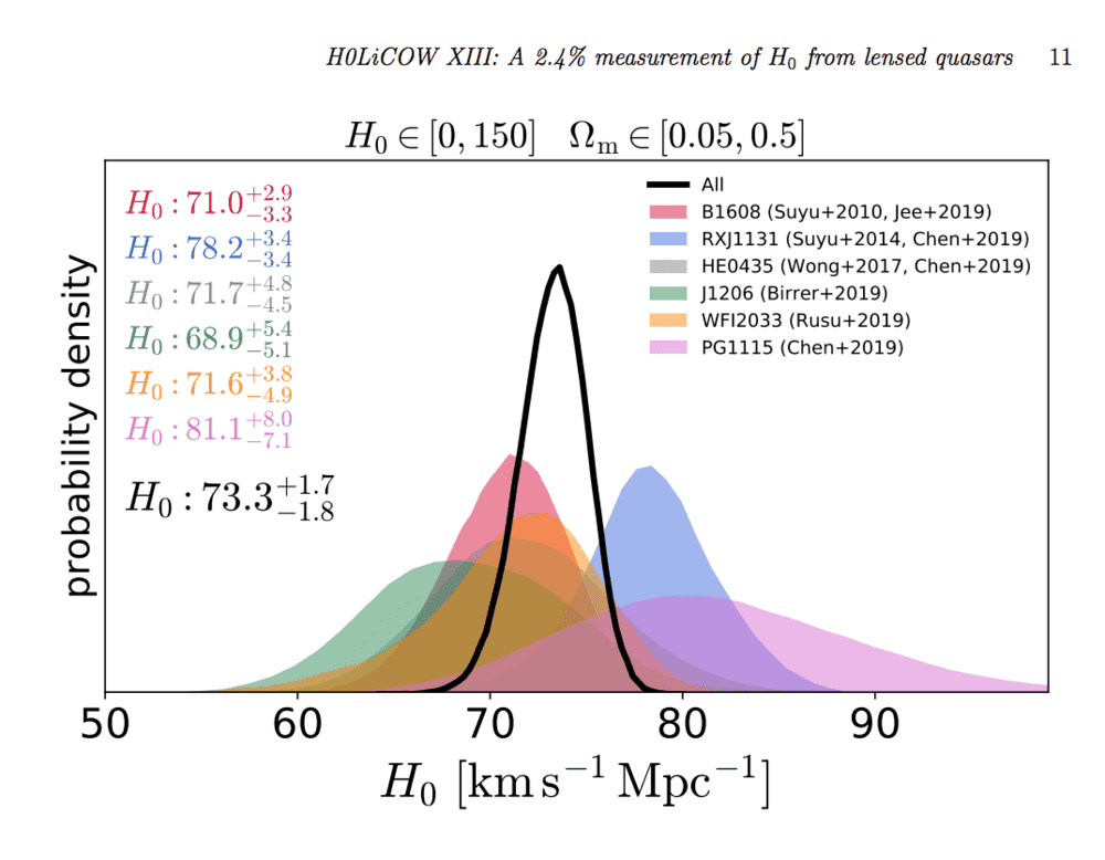

New measurement of the Hubble constant, increasing tension with measurements based on the CMB
The collaboration with the questionable acronym improved their measurement with a joint analysis of the whole dataset of six gravitationally lensed quasars. Measurements based on supernovae (measuring the Hubble constant "now") and measurements based on the cosmic microwave background (needing an extrapolation to get the current value) have been in disagreement for a while now. H0LiCOW has an independent method, its result fits well to the supernova results but not the CMB results.
H0LiCOW XIII. A 2.4% measurement of H0 from lensed quasars: 5.3σ tension between early and late-Universe probes
We present a measurement of the Hubble constant (H0) and other cosmological parameters from a joint analysis of six gravitationally lensed quasars with measured time delays. All lenses except the first are analyzed blindly with respect to the cosmological parameters. In a flat ΛCDM cosmology, we find ##H_0=73.3^{+1.7}_{−1.8}##, a 2.4% precision measurement, in agreement with local measurements of H0 from type Ia supernovae calibrated by the distance ladder, but in 3.1σ tension with Planck observations of the cosmic microwave background (CMB). This method is completely independent of both the supernovae and CMB analyses. A combination of time-delay cosmography and the distance ladder results is in 5.3σ tension with Planck CMB determinations of H0 in flat ΛCDM. We compute Bayes factors to verify that all lenses give statistically consistent results, showing that we are not underestimating our uncertainties and are able to control our systematics. We explore extensions to flat ΛCDM using constraints from time-delay cosmography alone, as well as combinations with other cosmological probes, including CMB observations from Planck, baryon acoustic oscillations, and type Ia supernovae. Time-delay cosmography improves the precision of the other probes, demonstrating the strong complementarity. Using the distance constraints from time-delay cosmography to anchor the type Ia supernova distance scale, we reduce the sensitivity of our H0 inference to cosmological model assumptions. For six different cosmological models, our combined inference on H0 ranges from 73-78 km s−1 Mpc−1, which is consistent with the local distance ladder constraints.

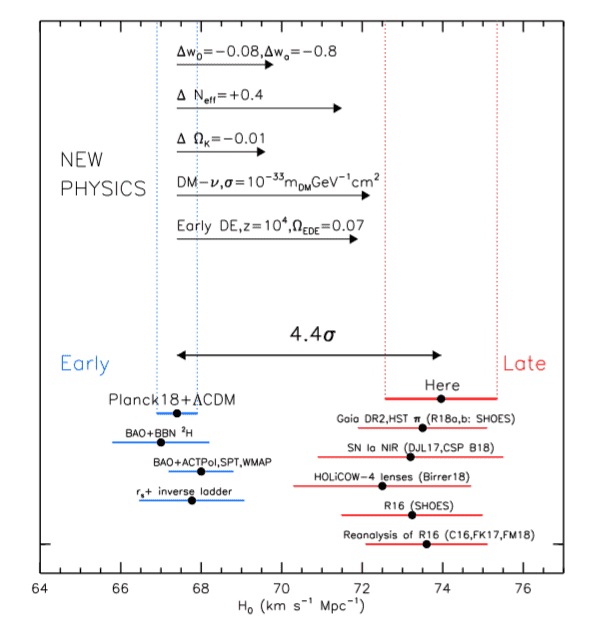

I also find a good picture from another recent article about the discrepancy on the ##H_0## value.
246606
https://arxiv.org/abs/1903.07603

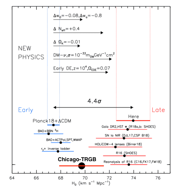

This paper came out today. A local measurement more in line with Planck. I added it to the graph below. The jury is still out on this issue.
