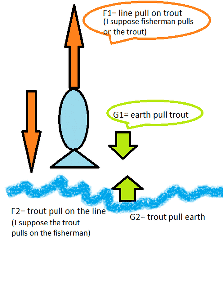

a) I had great difficulty with drawing the free body diagram of the trout. Especially difficult with regard to action reaction pairs. I didn't really understand what I was supposed to do, but I gave it a try anyway.

are the force pairs ¨(action reaction ) correct?
was the picture correctly drawn?
What would the vector sum calculation look like ("by the book way" in physics)
You did very well drawing the FBD. You correctly identified the force pairs.

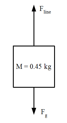

There are several different notations for vector algebra but I think at this point you can work with signed forces where the sign denotes the directional component of the vector.
You would start with a simplified FBD that includes just the external forces acting on the mass. In this case those would be the gravitational force and the fishing line force.:
Free-body diagram of a box labeled M = 0.45 kg, with an upward arrow labeled F_line and a downward arrow labeled F_g.
Then the sum of the forces yields the net force acting on the mass:
##F_{net} = F_{line} + F_g~~~~~~~~~~~~~~~~##...(1)
Choosing a coordinate system where "up" is positive and "down" is negative you write expressions for the known quantities:
##F_g = -M⋅g~~~~~~##{Simple force due to gravity}
##F_{net} = M⋅a~~~~~~~##{Newton's 2nd law}
Substitute into (1) and solve for ##F_{line}##.

why did you disregard the force action pairs in that free body diagram?
Was it unnecessary to draw them or something? I'm a physics noob I guess :nb)
Only external forces can change the state of motion of a mass (Newton's 1st law). Otherwise the force pairs cancel (action/reaction force pairs are always of equal magnitude but opposite in direction).
In order to answer the given problem you need only consider the external forces acting on the mass, so the paired forces can be dropped from the simplified diagram. For completeness you can include all the pairs if you like. Your force F2 ("Trout pull on the line") is associated with the inertial force that arises when the mass accelerates, and is the force that is paired with the net external force.
I was thinking along the same lines about the inertial force. According to the third law. That inertial force ought to exist. Because the hook must be attached to trout's mouth. Hook pulls on the jawline. jawline pulls on the hook.
If it's only a small fish like trout. Then, what tends to happen is simply that the fish accelerates and the line becomes "loose" and the fish becomes ballistic at the end of the line flying towards the fisherman more-or-less (essentially the fishing line just goes from taut to loose).
Well that's what I remember doing as a kid. It's been a while since I've been fishing anyhow.
I presume that the Force F2 would matter when it came to judging whether a particular fishing line can withstand particular force.

The fishing line is the conduit for an external force that is applied to the fish. Gravity supplies another. You're interested in the force that the line applies to the fish.
