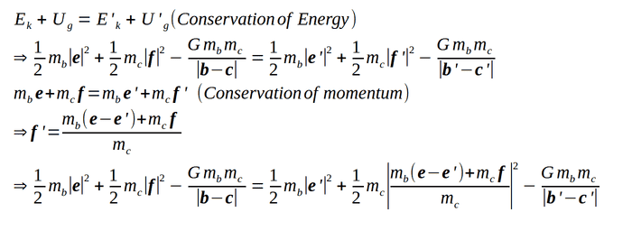

I'm working on a computer graphics program that simulates the motion of two point masses as indicated in this diagram:
After applying the laws of conservation of momentum and the conservation of energy I am left with the following equation to solve for e':
Does anyone have any idea how to solve this for e' which is the new velocity vector after a certain delta t?
It is a quadratic equation. You cannot divide by vectors so you have to be careful while solving it, but there is no magic needed.

So should I break down e, e' and f into their components?
I don't think you have to, apart from the last steps maybe.
What about b' and c'? You consider these known?

Yes, because they can be calculated according to b' = b + eδt.

Still not sure how to solve the above equation. Should I look at the equation for angular momentum too?
I just noted that your system is underconstrained - you have one equation for e' but two or three unknowns. I guess your acceleration should go in somehow.
I am treating the two body system as a state system.
b, c, b', c', e, f, mb, mc are all known.
Though b' and c' are calculated by approximation according to the equation b' = b + eδt.
Hope this clarifies what I am trying to achieve. I suspect that by quantizing δt I will not be able to conserve energy and momentum?
EDIT: added e to formula.

Do you have any suggestions as to how this equation my be solved for e' given all of the other variables may be considered as known?:
I don't think you can. You have three unknowns in the equation: the magnitude of e' and the projections of e' on e and f.
Which is quite normal, isn't it? e' is a vector in 3D so you need three values to describe it.
But if you assume that you know b', c' and f' by some magic, why not take it one step further and assume e' known as well? :smile:
What you say is true, I probably haven't sufficiently explained myself... f' can be eliminated by conservation of momentum as shown above.
b' can be eliminated with this approximation b' = b + eδt. Now I could obtain e' by a similar approximation but that would result in energy not being conserved due to the inherent graininess of the approximation which is the reason why I would like to solve the above equation. I am now looking into the conservation of angular momentum to give additional constraints.
