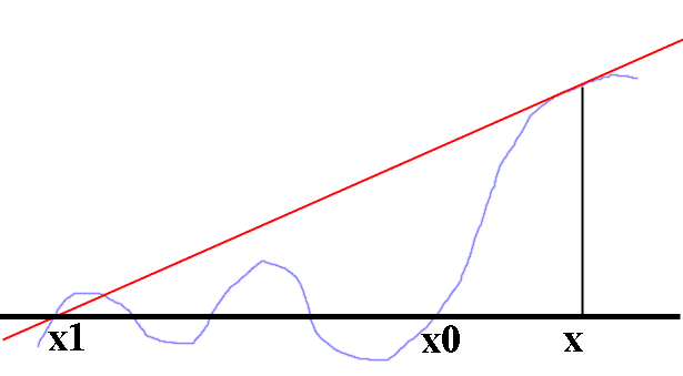

hotvette said:
Pure Newton's method, if it finds a solution (not guaranteed to find one), will find the one closest to the starting point
I don't think so.
Starting point x, yet solution found is x1, not x0. You need additional conditions for the statement to be true.
Borek said:
I don't think so.
Ah, right you are. I stand corrected.
You're welcome :wink:
To elaborate on Borek's comment, you can take additional steps to increase the odds of finding the root nearest to the starting point. One option is to take partial Newton steps, that is, use xi+1 = xi - mu*f/f', where mu is between 0 and 1. The smaller mu is, the more steps are needed to converge, but the less likely to miss the nearest root.
