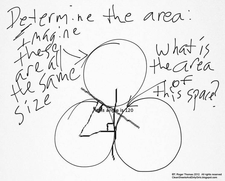

Recently, the following math problem was posed to me:
http://www.notobaccoads.com/Images/Math_FindTheArea.jpg
What that chicken scratch above shows is a problem I have not yet been able to solve. By what formula can one determine the area of the space in between three circles of the exact same size touching each other in the arrangement shown above?
The area in the middle isn't a straight edged triangle, it's a three sided space with each side having a curve that somehow relates to the diameter of each circle, I think.
If anyone has any thoughts on how to create a formula to solve for the middle area given any diameter for the three circles or if anyone could point me in the right direction I would appreciate it.

I have an idea to do this.(I assume that all the circles are of same radii)
first draw tangents at all the common points between the circles.By symmetry three tangents will cut in between the space between three circles and angle between three tangents will be 120 degrees(do you got it?).
Now area of space between three circles is =3(area_of_quadrilateral_formed_tangents_to_a_circle_and_corresponding_radii-1/6area_of_a_circle)
Do you understood how i write last line??
I doesn't understand what you write in right part of image...
see attachment i have edited and drawn tangents
for different radii see the link given by chiro. that requires knowledge trigonometry.

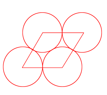

This can be solved pretty trivially. About 2 lines.
The trick is to rearrange it into areas much easier to calculate. By tiling.
Here is a big hint.
Here is a big hint.
