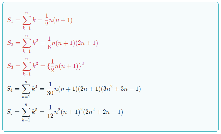

but after simplifying the first 2 innermost sums, I would start to need some formulas for "the sum of the first n numbers ^3,^4,^5,etc.".
which to my knowledge, closed expressions for that exist only for ^2 and ^3 at most.

but yeah, as you might have guessed, for like S(a,,n) with n=4 or bigger, you will inevitably coem face to face with having to solve a sum of cubed or higher potency numbers.
so 1^4+2^4+...+n^4 and such.
which might or might not even have an explicit formula.
not to mention that calculating each recursive step by hand until you reach S(a,b,n) is a huge PITA and super easy to make tiny mistakes that ruin everything :-/
