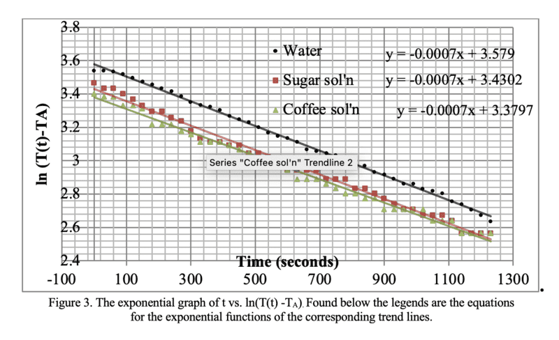

Find the value of k
T(t) = TA + (To - TA) e ^-kt
What's the value of k, given T(t) = 51 degrees, TA = 19 degrees, To = 80 degrees and t = 1200 s?
Should the value of k be positive or negative if an object is cooling down?

What must the sign of ##k## be in order that the object cools as time increases, i.e., so that ##T(t_{2})<T(t_{1})## for ##t_{2}>t_{1}##?
k should be positive, but when I plotted a graph of ln (T(t) - TA) vs t, I got a graph of negative k
Do you mean you got a graph of negative slope? That slope is not k.
Rearrange the equation into the form kt=… to find out what you should be plotting.

Why not just solve the logarithmic-form of the cooling law ##kt=\ln\left(\frac{T\left(0\right)-T_{A}}{T(t)-T_{A}}\right)## for k directly? (In this form it's clear that ##k## must be positive because the argument of the log is greater than 1.)

According to this source, the gradient is k (which is a negative value)
Note the logarithmic vertical axis
Where is ##k## mentioned on that screenshot? As implied in post #45, ##k## is proportional to the negative of ##\ln\left(T(t)-T_{A}\right)##.
And what does the label on the y axis say?
ln T(t) - TA
sunmoonlight said:
ln T(t) - TA
Which is not ##k##.
Now, how do you get ##k## from ##\ln (T(t) - T_A)##?

To me, this question is meaningless and could be confusing because it is the argument of the exponential that counts. Parameter ##k## is the inverse of a time constant and, as such, it should be positive. With ##k## positive and ##t## also positive, the argument of the exponential must be negative when the object is cooling down and positive when it is heating up. In other words, the negative sign in front of the argument ##kt## is or is not there depending on what one wishes to describe.
##T(t) = T_A + (T_0 - T_A) e ^{-kt}##
##T(t) -T_A = (T_0 - T_A) e ^{-kt}##
##\ln(T(t) -T_A) =\ln( T_0 - T_A)+(-kt)##
So what will be the gradient of ##\ln(T(t) -T_A)## plotted against ##t##?
-k
I got that. Thanks a lot.
