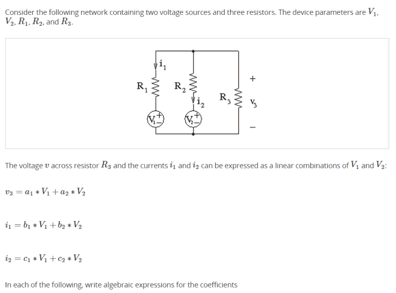

Circuit schematic of a network with two voltage sources V1 and V2 and three resistors R1, R2 and R3, with loop currents i1 and i2 and the voltage v3 across R3 marked.

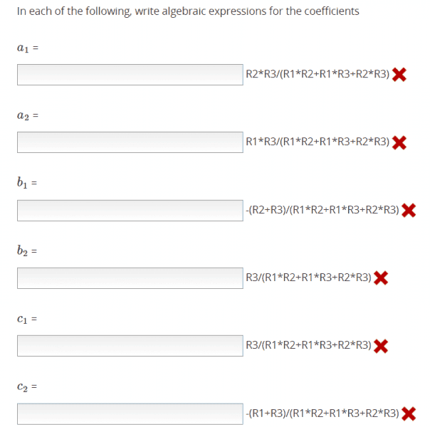

Form with six input fields for coefficients a1, a2, b1, b2, c1 and c2, each marked with a red X and showing an incorrect expression beside it, such as R2*R3/(R1*R2+R1*R3+R2*R3) for a1.

I believe my a1 and a2 are correct.
But my b1 is definitely wrong. Even if I carry out the above subtraction for the v1 part (which gives you b1) I will not have somethign as simple as R2 + R3 on the numerator
Web form showing the label b1 = followed by an empty answer box and the entered expression -(R2+R3)/(R1*R2+R1*R3+R2*R3), marked with a red X for incorrect.

  • Screenshot of a web quiz asking for algebraic expressions for coefficients a1, a2, b1, b2, c1 and c2, with blank answer boxes and red X marks beside each submitted answer in R1, R2, R3 terms.
