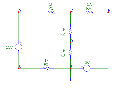

Use the Node Voltage method to solve

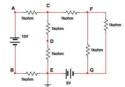

From the above circuit find VCB and VDG
Know Data:
VE = 0 (ground)
KCL and Ohm's Law are used in Node Voltage Method.
I decided I would determine the node voltages then work out VCB and VDG afterwards.

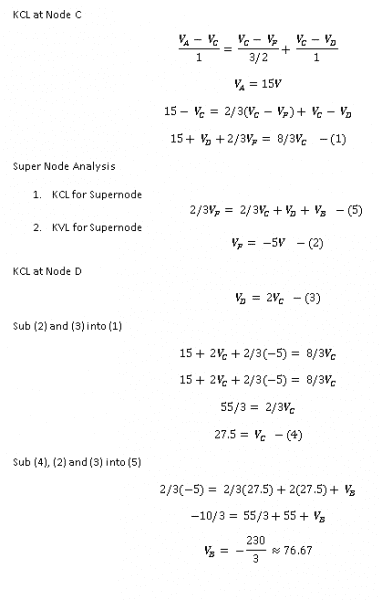

1. KCL and Ohm's law at Node C
## 15 + V_F + V_D = 3 V_C## -(1)​
2. Super Node at EG
2.1 KCL and Ohm's law for all currents entering
## 2(V_F - V_G) = 2 V_E - V_D - V_B##
## 2(V_F - V_G) + V_D + V_B = 2 V_E## -(2)​
2.2 Potentials at Nodes E and G
## V_G = -5V## -(3)​
3. KCL and Ohm's law at Node D
## V_C = 2 V_D## -(4)
This is as far as I got I am unsure what to do next so I can get 5 equations so they can all be solved simultaneously.

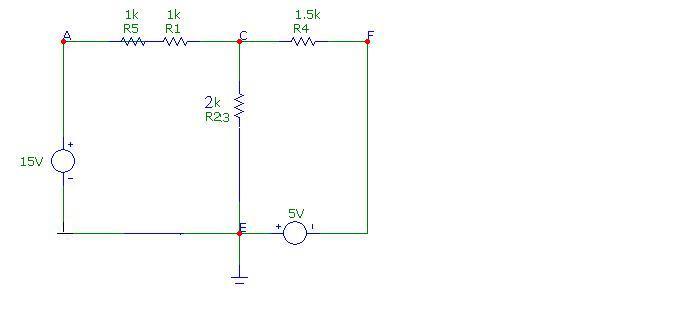

The problem highly simplifies if you replace the series and parallel resistances with their resultants.
So if I replaced the two between F and G, and the one between C and F right?
Yes, and the two resistors between C and E, and also the two resistors in series with the 15 V battery.
In the simplifed circuit, you can find the voltage VC with the node voltage method . Knowing Vc, you can calculate the currents, and knowing the currents, you can determine all node voltages.
Simplified Circuit.
This is what I have done. Not sure if correct?
How would I find VB? Is VA really = 15V.
NOTE: VD = 2VC so it can be eliminated.

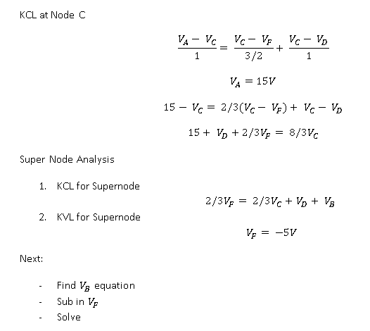

cavalieregi said:
Simplified Circuit.
Actually I think I have it just wait.
Simplified Circuit.
I think I have made a mistake somewhere.
NOTE: VB is meant to be negative at end where = 76.67V
Your solution is very complicated...
The circuit is equivalent with the one in the picture, except B and D nodes disappearing. You can solve it for Vc.

No, VA is not 15 V, as we count the potential with respect to E. VA-VB=15 V
I figured Va = Vb + 15 and it worked!
