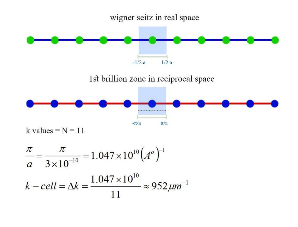

i did something wrong , i guess the length of the brillion zone is
$$ \frac{2π}{a} = \frac{2π}{3*10^-10} = 2.094*E10 A^- $$
$$dK =\frac{2.094E10}{11} =1.9*10^9 A^-$$
the allowed values of k i guess would be multiples of dk ,1dk,2dk ...

No, the allowed k values depend on the size of the lattice. You remembered that in your first post.
There are as many allowed k values in the first Brillouin Zone, as Brawais cells in the real crystal, that is 11 in this problem. You know the size of the cells in the reciprocal lattice (what did you get at last?) : the Brillouin Zone is the Wigner-Seitz cell in that space. If the lattice points in the real crystal are at x= 0, +-a, +-2a... those of the reciprocal lattice are at n2pi/a. The Wigner Seitz cell in he real lattice is symmetric to x=0, the edges of the first one are at -a/2 and a/2. The First Brillouin Zone in the reciprocal lattice is analogous to that.
k means a point in the momentum space (reciprocal space) as x means a point in the real space. k is the wave vector of a wave traveling in the crystal. Two waves are identical if their phase differ by a reciprocal cell vector. You certainly learned about it!
thanks for helping , so there are only 11 allowed values of k with an interval between them = 2π/Na = 0.19A.

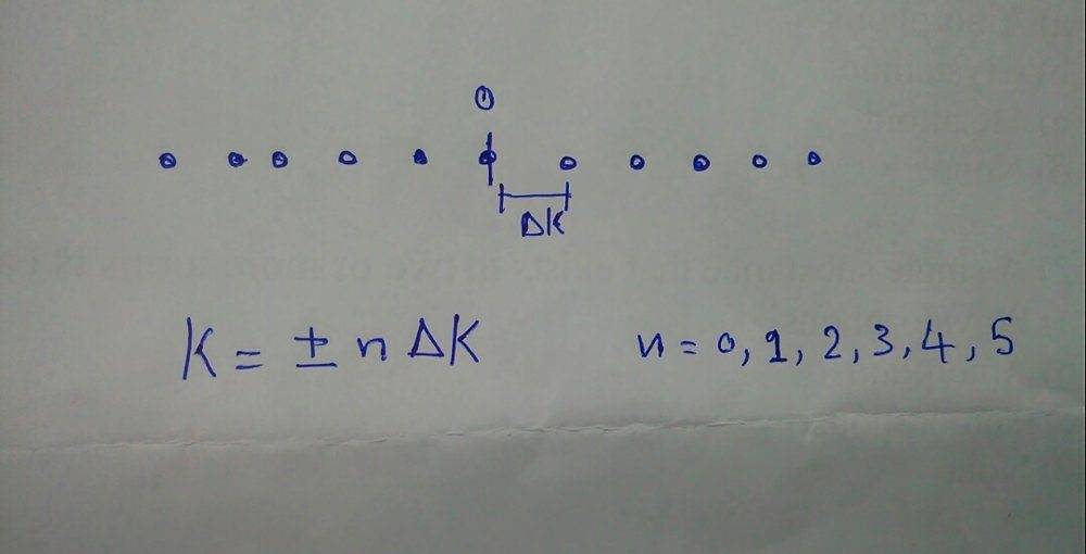

Yes, there are 11 allowed values of k in the first Brillouin zone (what is its size?) The problem asks you to give these k values.
i would say k = 0.19 , 0.38 ,0.57 ,0.76 ,... up to 2.09 as an integer multiples of dk
The Brillouin zone is a Wigner-Seitz cell, symmetric to k=0. Is k=0 also allowed? And what is the unit of k? It is not A as you wrote.
A^-1
patric44 said:
Nice! :cool:
Do not forget, that k is a wave-vector, and the wave can travel forward and backward, so k can be both + and -
