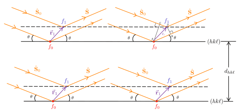

Things aggravate when Hammond derives the equation for the structure factor in Chapter 9, as follows:
The position vector ##\va{r}_1## is written as$$\begin{equation}
\va{r}_1 = \sum_{i=1}^3 x_i \va{a}_i
\end{equation}$$where ##\va{a}_i## are the lattice basis vectors, and ##x_i## are \textit{fractions} of the cell edge lengths.
The path difference,$$\begin{align}
\mathrm{P.D.} &= \mathrm{AB} - \mathrm{CD} \nonumber \\
&= \va{r}_1 \vdot \vu{S} - \va{r}_1 \vdot \vu{S}_0 \nonumber \\
&= \va{r}_1 \vdot ( \vu{S} - \vu{S}_0 ).
\end{align}$$
##\because## Bragg's Law is satisfied, we can write using ##\text{eqn.}~\eqref{eq:bragg_law_vector}##,$$\begin{align}
&\phantom{\implies} ( \vu{S} - \vu{S}_0 ) = \lambda \va{G}_{hk\ell} \nonumber\\
&\phantom{ \implies ( \vu{S} - \vu{S}_0 ) } = \lambda \qty( h \va{g}_1 + k \va{g}_2 + \ell \va{g}_3 ).\\
&\implies \mathrm{P.D.} = \lambda \qty( x_1 \va{a}_1 + x_2 \va{a}_2 + x_3 \va{a}_3 ) \vdot \qty( h \va{g}_1 + k \va{g}_2 + \ell \va{g}_3 ) \nonumber \\
&\implies \mathrm{P.D.} = \lambda \qty( h x_1 + k x_2 + \ell x_3 ). \label{eq:path_difference}
\end{align}$$where we have used ##\va{g}_i \vdot \va{a}_j = \delta_{ij}## to arrive at the last step.
The phase angle is given by$$\begin{align}
\phi &= \dfrac{2\pi}{\lambda} \mathrm{P.D.} \nonumber \\
&= 2 \pi \lambda \qty( h x_1 + k x_2 + \ell x_3 ).
\end{align}$$
Adding the scattering amplitudes ##f## with their respective phase angles ##\phi## in the complex plane,$$\begin{equation}
\boxed{F_{hk\ell} = \sum_{n = 1}^N f_n ~ \exp \qty[ 2\pi i \qty( h x_n + k y_n + \ell z_n ) ].}
\end{equation}$$
