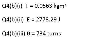

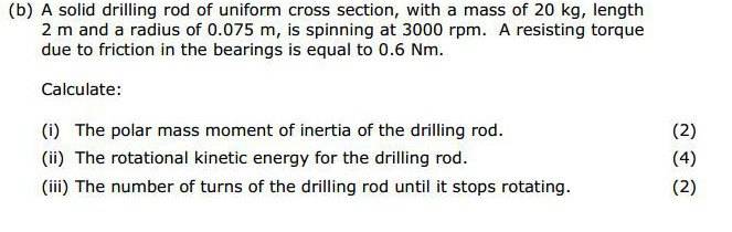

Having problems with (b)(iiI).
I've tried using the kinetic energy value = work done and dividing that by torque.
I've also tried used the other circular motion formulas but haven't had any success.
Attempt:
Wd = θ x T
Ek(from b ii) = Wd
θ = 2278.29/0.6
= 3797 turns
Show us what you've tried.
I've added what I tried.
I'm asking about a different question here, previous one was in regards to (b) (i), this is (b)(iii).
θ = 2278.29/0.6 = 3797 turns
Two errors..
1)Typo.. 2278.29 should be 2778.29
2) Check the units of angular displacement θ. (Hint: it's not turns)
