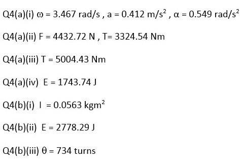

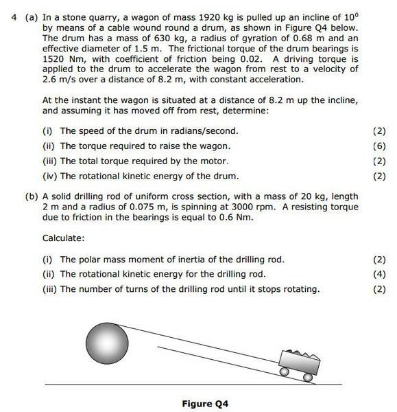

Hi, I'm having problems with 4. (a)(iii) and (b)(iii).
Question and solution attached below.
For 4.(a)(iii) this is what I've tried (for mass I've used the mass of the wagon plus drum):
F = Fu + Ff + Fw
= (ma) + (mg x cosangle x friction coefficient) + (mg x sinangle)
= 2550 x 0.412 + 2550 x 9.81 x cos10 x 0.02 + 2550 x 9.81 x sin10
= 1050.6 + 419.8 + 13608.96
= 15079.4Nm
(b)(iii)
Help is much appreciated.
That's not correct, you can't add the mass of the drum to the wagon. The drum isn't accelerating in a straight line, it's rotating.
First off don't sum the forces. Work out all the torques acting on the drum and sum them instead. For example one of the torques will be due to the tension in the cable. Another will be the torque required to accelerate the drum (angular acceleration). Find the equation that relates torque and angular acceleration.
Edit: There are other torques that have to be overcome. Make a list.
I see you have two questions/threads running. Looking at both of these threads it seems the difficulty you are having is the same in both cases. Perhaps read up on moment of inertia and understand the similarity between the equations for linear motion and rotation...
Linear.......>.......Rotation
Force = mass * acceleration.......Torque = moment of inertia * angular acceleration
Work = force * displacement.......Work = torque * angular displacement
Power = force * displacement/time......Power = torque * angular displacement/time
Power = force * velocity.........Power = torque * angular velocity
