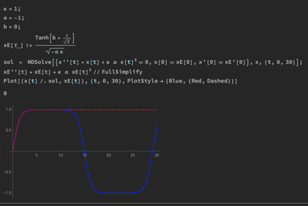

Hi PF
The following ODE
$$\ddot x + x - x^3 = 0\\
x(0)=0,\,\,\,\dot x(0) = \frac {1}{ \sqrt 2}$$
is solve exactly with ##\tanh (t/\sqrt 2)##. However, when I try to solve this with MATLAB ode45 (ode23t looks identical) or Mathematica NDSolve I get an oscillatory numerical solution (see attached).
Any idea what's going wrong?

See that's what I thought. However, check out this Mathematica snippet, specifically the ODE being exactly solved by ##xE##, and how it's the same as the numerical ODE.

So maybe ode45 is not the right ODE for this problem. It works initially but the deviates at x=10
That's what I thought too, but some others failed, so I switched to Mathematica, and it failed too! Any ideas about the oscillations? Looks so unusual.
It looks like a flattened sin curve. It you'll recall the x'' + x = 0 has sin/cos solutions. Since its flattened then maybe its something approaching a square wave.
Try some other ODE like ODE23 or ODE?? from that reference I gave you in another thread for MATLAB.

Numerical solutions don't necessarily give good solutions over a large interval. Your numeric solution matches the exact solution pretty well when x is close to 0, the value used in the initial conditions. When x is relatively far away from 0, the numeric solution varies considerably from the exact solution.

ODE45 and NDSolve don't know anything about the analytic solution. All they have to go on are the differential equation and initial conditions, and they use this information to get another solution point. The farther away you get from, in this case, t = 0, the less accurate the computed solution is.
Check what happens to the numerical solution when you start at ##t=10## with the exact value as a starting point.

In Mathematica if I compare the results of NDSolve with the default MachinePrecision versus WorkingPrecision->64 I find the same oscillatory result in the first case and the expected more accurate behavior in the second.
Code:
sol1=x[t]/.NDSolve[{x''[t]+x[t]-x[t]^3==0,x[0]==0,x'[0]==1/Sqrt[2]},x[t],{t,0,30}][[1]];
sol2=x[t]/.NDSolve[{x''[t]+x[t]-x[t]^3==0,x[0]==0,x'[0]==1/Sqrt[2]},x[t],{t,0,30},WorkingPrecision->64][[1]];
Plot[{sol1,sol2},{t,0,30}]
If I drop that WorkingPrecision down to 32 then the oscillation begins, but later than when using MachinePrecision.

It doesn't matter how much precision you use. The point x = 1 x' = 1 is an unstable point in phase space.
You can easily see this by making this into a physical problem. You have a conservative force here of x^3 -x, and a mass 1. f=ma will give x'' = x^3 - x. What you are really doing is rolling a ball up a hill (without friction) and trying it to come to rest on the top of a hill. If your initial speed is bigger than 1/sqrt(2) no matter how little, the ball will over shoot and roll down the other side. If the speed is too small, the ball won't get to the top and will roll back towards x=0 and go up the hill towards x=-1 (what you are seeing now). Since 1/sqrt(2) does not have an exact digital representation, all computations can't start with the right initial speed, and they are doomed from the start.
The differential equation has no exact solution where the ball actually comes to rest on the top of the hill, the exact solution you computed will never reach x=1, while the speed becomes smaller and smaller. At some point the numerical error will make it roll back down or overshoot the hill.

what always seem to happen when you implement the system
v' = x^3 - x
x' = v
you will use this in practice.
xn+1 = xn + v Δt
vn+1 = vn + (x^3 - x) Δt
since x is around 1 and v is around 0, the absolute error for floating point numbers is much bigger for x, than for v. At some point the next value of x you compute will be equal to the previous value, while x is still < 1.
(x^3 - x) will remain constant and v will become negative.
Using a better integration method won't help at all, if you use the same time step because this will happen whenever v Δt becomes smaller than the smallest difference between two floating point numbers.
Only increasing the accuracy of the floating point numbers will help, and decreasing the time step will make it worse.
