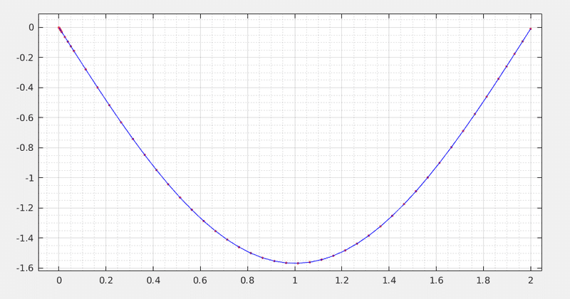

For ##E = 0.392##, I get this figure:
Apparently, this is the same figure for the first stationary state, but with the graph inverted. Any idea what I am doing wrong?
Edit: Code and figure generated by it didn't match; edited to fix it.[/size]

Looks good. The phase or sign of ##\psi## is arbitrary. You are free to choose it.
Oh, you plotted ##-psiVal## BTW
My bad; I was debugging, and plotting -psiVal gave me the correct graph. I have edited the code.
The slope ##\psi’(0) \lt 0## yet you’ve set it to 1. Why is this?
No idea. Even I was wondering why this happened.

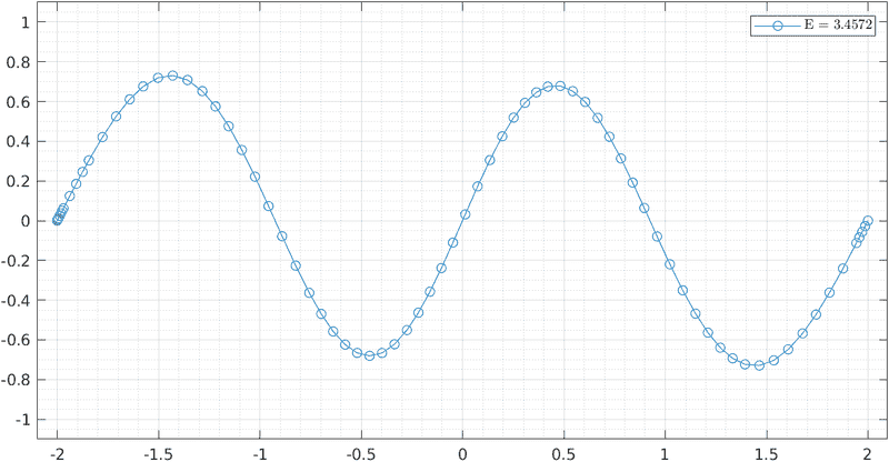

Using this function and the script file posted earlier, I get the following correct graph:
You are showing what looks like the ground state waveform and the third excited state or fourth energy level. What did you compute for the ground state energy? Are the two energy levels in the proper ratio of 16 to 1?
There can be several problems here. My function can be simply wrong. But I am using ode45, which won't return a wrong result. So, the way I am varying the energy such that psi(xEnd) is as close to 0 as possible might be wrong. Or, the potential function (which I forgot to post earlier) itself might be wrong because I devised it myself.

I thought this was an infinite square well. Your potential looked correct. My question is about the assumption of X0. You have X0=-2 but maybe the program assumes X0=0?
Since Energy =##n^2 \pi^2/L^2## for a total well width of 4 as you have the energies are ## \pi^2/16## for the ground state and ## \pi^2## for the fourth state you show. If you can get the correct ground state the others will work out.

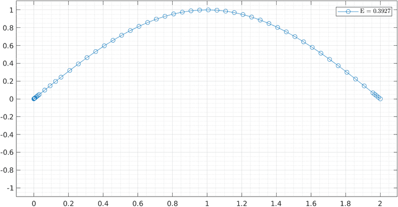

For the infinite square well potential, I am using the following:
Matlab:
psi0 = 0;
psiEnd = 0;
x0 = 0;
xEnd = 2;
m = 2;
E_guess = 0;
maxError = 1e-10;
hold off;
[E, xVal, normalPsi] = TISE_shootingAlgo(psi0, psiEnd, x0, xEnd, m, @Vx_infSqWell, E_guess, maxError);
plot(xVal, normalPsi, '-o', 'DisplayName', ['E = ' num2str(E)]);
grid on; grid minor;
hold on;
xlim([x0-0.1 xEnd+0.1]);
ylim([-1.1 1.1]);
legend('Interpreter', 'latex');
function V = Vx_infSqWell(x)
    L = 2;
    if (0 <= x) && (x <= L)
        V = 0;
    else
        V = 9999999;
    end
end
and I get this graph:
Analytically, as you said, it should be 0.61685. The value calculated from my program is way off. I am not sure where the problem is occurring.
Matlab:
psi0 = 0;
psiEnd = 0;
x0 = 0;
xEnd = 2;
m = 2;
E_guess = 0;
maxError = 1e-10;
hold off;
hold on;
ylim([-1.1 1.1]);
    L = 2;
        V = 0;
    else
        V = 9999999;
    end
end

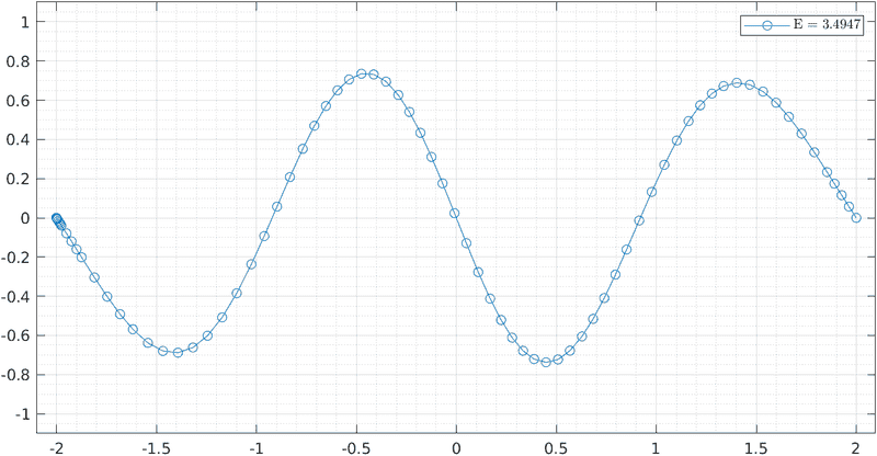

The first plot of the ground state goes from 0 to 2 but the second plot of the ##n=4## plot goes from -2 to 2.
I suggest seeing if you can go through an iteration of the algorithm by hand if you have the actual code to follow.
bob012345 said:
Can you do a couple of hand iterations of you algorithm?
I think you are confusing post #13 with #17. The former is for the harmonic oscillator, while the latter is for the infinite square well.For the infinite square well, here is a graph of the eigenfunctions and the corresponding energy eigenvalues for different levels:
I agree that the energy eigenvalues don't match the analytical values. And I don't have a clue where the error is.

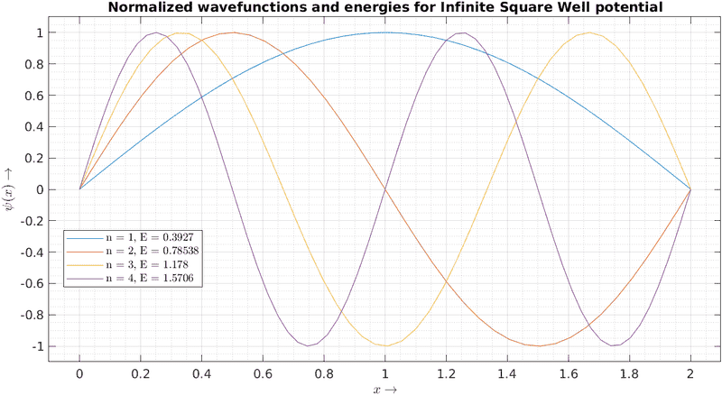

I'm going to answer the for the case of the infinite square well with a total well width of 2 as shown above by you. Thus the energies should be ##n^2 \pi^2/8ma^2## where the well goes from -a to +a so in this case a=1. Therefore the energies are ##n^2 \pi^2/4## since m=0.5 as specified above. The ground state energy should be 2.4674 now.
Looking at your numbers for the infinite square well, the ground state is off by almost exactly a factor of ##2\pi##. Then, the energies should scale as ##n^2## and not ##n## as your energies scale above. These are clues as to where to look.

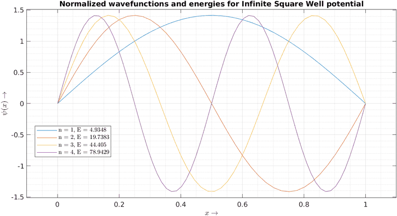

Eureka! Found the problem! In the code I posted in post #13, line 30 is wrong. It should be:
k = @(x, E) sqrt(2 * m * (E - Vx(x))) ./ hbar;
For the infinite square well, with L = 1 and m = 1, now I get:
