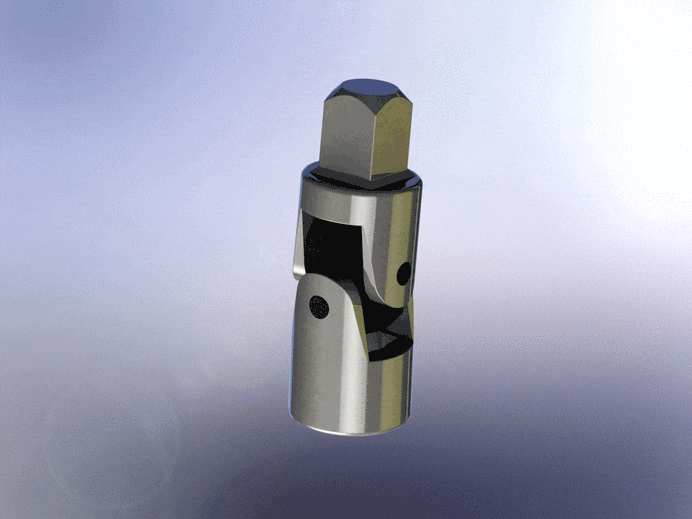

Aha now I see it. Have a sphere with a rod through the center protruding from the north and south poles. Have a ring that's larger than the sphere with a slot on the inner edge. Put the ends of the rod in the slot. If the ring is in the yz plane then the rotational plane of the sphere can have any combination of the xy and xz planes but no element of the yz plane.
Doesn't this work as you expect?

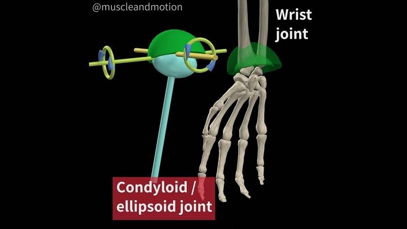

I also found an "ellipsoid" joint:

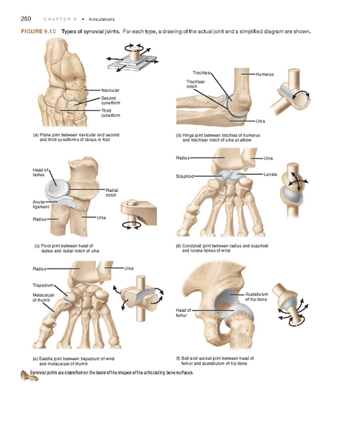

These are the kinds of joints you find in your articulations, like your wrists and fingers (you can look up condyloid joint):
