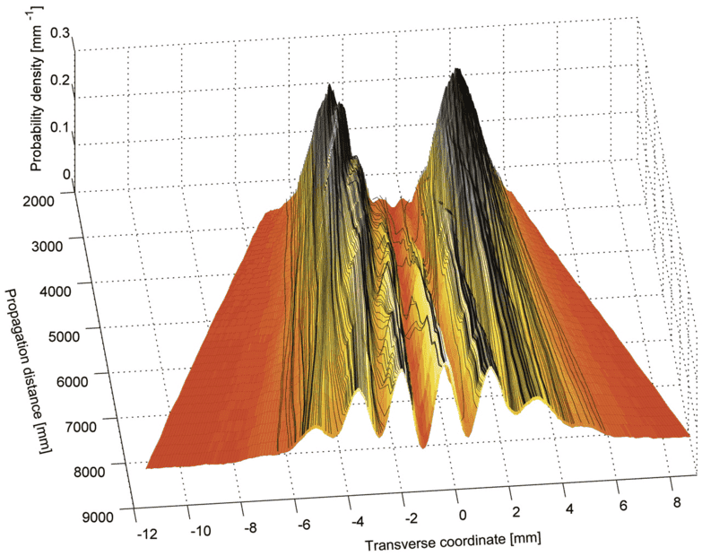

Weak measurement allows to measure in weakly enough way not to destroy interference, but still allowing to get e.g. mean trajectories from statistics: https://science.sciencemag.org/content/332/6034/1170
On the top you can see the 2 slits, on the bottom interference pattern:
3D surface plot of probability density in mm^-1 against transverse coordinate in mm (-12 to 8) and propagation distance in µm (2000 to 9000), showing two sharp peaks with an interference-like dip between them.

The strong emphasis here is on "mean". The weak measurement does not provide information on which path any individual photon took.
Exactly - strong measurement would destroy interference, weak allows to avoid it - finding mean trajectories from statistics, which agree with dBB:
Single-particle trajectories measured in this fashion reproduce those predicted by the Bohm-de Broglie interpretation of quantum mechanics, although the reconstruction is in no way dependent on a choice of interpretation.”

"Allows to find it" is a misleading statement. This is the same result you get from tracking the Poynting vector of a classical wave. You could "find" these trajectories just as well by putting the observation screen at different distances to the slit and recording the interference patterns at the different distances. Actually, this is what has been done in the figure you posted. The figure shows the strongly measured interference patterns. The results from the weak measurement are shown by the black lines for comparison. Sure, performing this strong measurement does not carry any information about the individual photons, but neither does the weak measurement.
Weak measurements have their uses, most prominently in open systems. It is also important to understand how they differ from strong measurements to avoid some pit traps in thought experiments involving, e.g. tiny momentum exchange. However, in this thread, they may be somewhat off-topic.

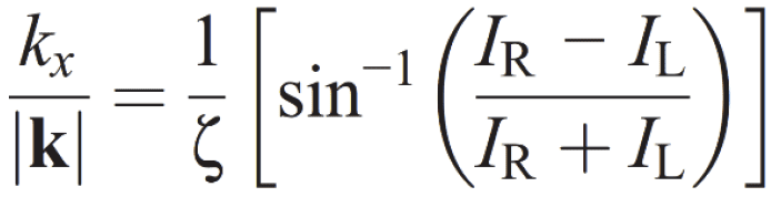

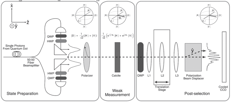

Ok, to be more specific: they encode which-path information in polarization (using birefringent crystal), then use polarization beam displacer for the photons to get to one of 2 (L,R) CCDs, and calculate mean momentums from differences of their statistics:
Equation: k_x divided by the magnitude of k equals one over zeta times sin inverse of the fraction (I_R minus I_L) over (I_R plus I_L).

It is also not correct. They do not encode which-path information anywhere in the polarization. All the photons are prepared with diagonal polarization. They then use an off-axis oriented piece of calcite to slightly rotate the polarization of the photons. The rotation depends on the path through the calcite crystal and thus depends on the angle with which the photons arrive - which corresponds to momentum. They then go on to use a set of lenses to image individual planes at different distance between the double slit and the calcite crystal onto a CCD. This yields the position information. The polarization one finds at each position provides (due to the calcite) a weak measurement of the mean momentum of photons arriving at this very position.
It is the weak momentum information that gets encoded in the polarization, not any "which path" information. Still, I do not see how all of this is relevant to the topic at hand. Could you explain why you think it is?

My mistake - you are right: calcite is to encode momentum, not which-path information.
Here is the setting:
Schematic of a weak measurement setup: single photons from a quantum dot pass a 50:50 fiber beamsplitter, state preparation with QWP, HWP and polarizer, then a calcite crystal, QWP, lenses L1 to L3 with a translation stage, a polarization beam displacer, and a cooled CCD, with Bloch sphere insets.
