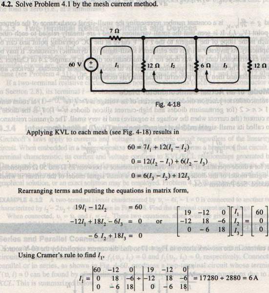

The problem that this thread is about is problem 4.5 which is in the 4.5.jpg file (which makes reference to problem 4.2 which is in the 4.2.jpg file).
##R_{transfer,ij}## = ##Δ_R## / ##Δ_{ij}##
This concept of "transfer resistance" seems to be something not discussed frequently. I checked my other book for that term/concept and, I couldn't find anything. When I check online, I find many not-directly-related things in the field of heat transfer.
Am I correct in thinking that it is, basically, an equivalent resistance of a certain segment of an electrical circuit (or all of it) defined to be located at a certain point in the electrical circuit?
While it makes some sense to me that R = V/I = V/(V ##Δ_{12}## / ##Δ_R##) = ##Δ_R## / ##Δ_{12}## because this derivation is similar to the derivation of the previous problem (4.4) in my book, I do not understand what is going on.
I suppose I understand how to do this problem, computationally but, I don't truly know what it is I'd be doing if I just blindly computed things. Assuming I understand what a transfer resistance is (from what I said above), how do I know where in the electrical circuit to define each equivalent resistance?
Any input would be greatly appreciated!

If I did not include enough information, someone please tell me so that I can incude it.
