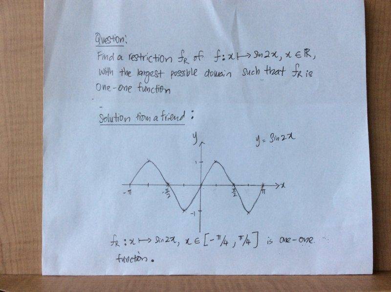

Dear Mentors and PF helpers,
Please help me to understand this question. Thank you for your time.
[/B]
My understanding of a one-one function is that if a horizontal line where to intersect the curve, there should be only 1 intersection.[/B]
1) My questions is what does "the largest possible" domain means?
Does it mean to find the widest interval between the lower limit and the higher limit? Or does it mean that the upper limit should be as great as possible?

No, it means the largest interval on the horizontal axis for which the function is one-to-one.

Than can the answer be [ pi/4, 3pi/2].

No, that's too large an interval.
Dear Sirs,
Why it is too large an interval? That section that I mentioned is also within the definition of a one one function. Why it is that we have to specifically choose [-pi/4,pi/4], there are many sections to choose as well.

Because your function is not one-to-one on that interval (i.e., on ##[\pi/4, 3\pi/2]##. Did you mean ##[\pi/4, 3\pi/4]## instead?
Yes, any interval of the right length will do. What you want is an interval on which the function is either increasing on the entire interval or decreasing on the entire interval.

Sorry I typed wrongly, you i mean [ pi/4, 3pi/4 ]. So my answer should be acceptable as well?
LiHJ said:
Dear Sirs,
I'm not sure. The question was "what is the largest possible domain?" so I think they are looking for an interval length rather than an interval. The length of the largest possible domain is ##\pi/2##.
