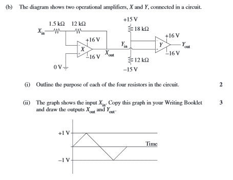

https://physicsforums-bernhardtmediall.netdna-ssl.com/data/attachments/73/73750-4bf3d2aa03a724fcf0b13a6b1111902f.jpg
V+ > V- for Vout to be +16V
V+ < V- for Vout to be -16V
V+ = -8x(in)
V- = (-15x18)/30 + (15x12)/30 = -3
My attempt on it was that -8X(in)V greater or equal to -3V for Yout to +16V
(EDIT: Then that would be Xin < 0.375 for it to be +16V
But the answer is saying the opposite.)
But this was the solution and it showed the opposite (that -8x(in) less that or equal to -3)[/B]
https://physicsforums-bernhardtmediall.netdna-ssl.com/data/attachments/73/73751-f11fe983c5d64cca6eb97cffb930e594.jpg This was the answer
Do you mean.. Yout is 16V if -8X(in)V greater or equal to -3V ?
In which case that is correct.
Their solution looks correct to me. As a check try setting Xin = 1V and work out Xout, Yin, Y+ and Yout.
My mistake for not completing my answer.
And yes, that's what i meant, When -8(xin) was greater than -3 then the Vout would be +16V
Yout is -16V when Xin < 0.375
No the graph shows that when Xin is < 0.375 then Yout is +16v. For example at t=0.
The output graph is wrong. The transition of Yout going from -16V to +16V occurs when Xout = -3V, not -1V as shown.
No.
Sorry guys, I just read the graph incorrectly.
Thanks for pointing that out.
