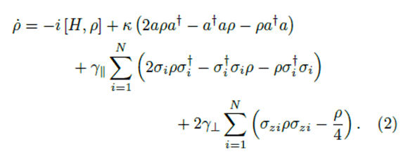

In the pape: Bistability effect in the extreme strong coupling regime of the Jaynes-Cummings model by A Dombi et.al
"Optical bistability is a benchmark of nonlinear lightmatter
interaction...Fluctuations are due to the dissipative processes, whereas the switching(Bistability) originates from a highly nonlinear dynamics." From the same paper, "the system :
and the master equation:

But only in the absence of interaction with the environment, which causes energy dissipation and hence activates the bistability under appropriate conditions. The resulting Lindblad equation (2) can no longer be diagonalized. The mean equation (4) becomes linear only if g=0 and inherits from the nonlinear Hamiltonian the nonlinear term ##S^*\alpha+\alpha^*S##.
