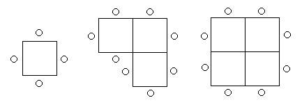

We wish to find how many people can be seated around a table. We may form larger tables by pushing together smaller square tables and arranging people as shown in the diagram:
There are two rules we are required to follow when pushing the smaller tables together and arranging the people around the larger table:
  • Only 1 person may be seated at one side of a smaller table
  • The larger table must be made as square as possible
Determine:
a) The number of people that may be seated for a given number of smaller tables.
b) The minimum number of smaller tables required to seat a given number of people.

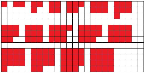

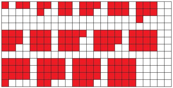

This is the "algorithm" I used for forming the larger tables:
While there are other ways to go about it to get the same results, to me this is the most straightforward way to approach the problem.

For a), it seems like there is no general formula for the number of people. If a table is placed in a "corner", the number of people stays the same. Otherwise, it increases by two. It's hard to tell where a table is going to be placed in advance.
b) only works if the number of people is even. But there also seems to be no formula.
It seems like a pattern on creating the tables , we start by ,say, a square then we add 1 square so it becomes a rectangle then we add two units it becomes a square then adding two units it becomes a rectangle adding now three units it becomes a square again and so on .
So Assume that We start by a square we add a number of units equal to its length that transfers it to a rectangle with a parameter in terms of the length of the square .
So nice structure .
