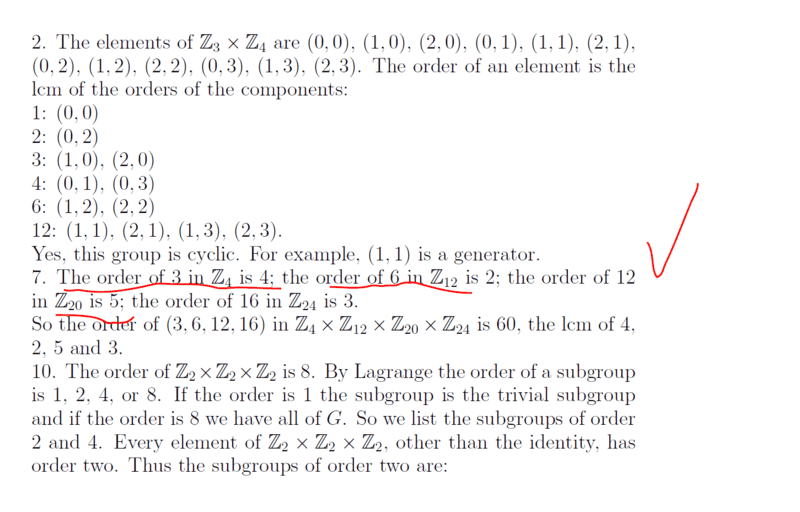

Doing some self study here; my understanding of order of an element in a group is as follows:
Order of ##3## in ##\mathbb{z_4}## can be arrived by having, ##3+3+3+3=12≡0##
likewise, the order of ##12## in ##\mathbb{z_{20}}## can be arrived by
##12+12=24 ≡4≠0##
##12+12+12=36≡16≠0##
##12+12+12+12=48≡18≠0##
##12+12+12+12+12=60≡0⇒12^5=0##
therefore the order of ##12## in ##\mathbb{z_{20}}=5##. Any insight is welcome.
Quicler is, for positive integers [itex]n[/itex] and [itex]m[/itex], [tex] 12n - 20m = 4(3n - 5m) = 0\quad\Leftrightarrow\quad (n,m) = (5k,3k), k \in \mathbb{N}[/tex] and the order of 12 in [itex]\mathbb{Z}_{20}[/itex] is found by taking [itex]k = 1[/itex].

This part is quite clear... that is:
##3## in ##\mathbb{z_4}=4##
##6## in ##\mathbb{z_{12}}=2##
##16## in ##\mathbb{z_{24}}=3##
and
lcm ##(4,2,5,3)=60##
Looks easy to apply, then for
##16## in ##\mathbb{z_{24}}## we shall have,
##16n-24m=8(2n-3m)=0## ...
##(3k,2k)##, on taking ##k=1## we shall then have the required ##n=3##.

Let me have this here for future reference...my way of attempting,
##\mathbb{z_3} ×\mathbb{z_4}=(0,1,2) ×(0,1,2,3)##
Giving us,
##(0,0), (0,1), (0,2), 0,3)##
## (1,0), (1,1), (1,2), (1,3)##
##(2,0), (2,1), (2,2), (2,3)##
the order is ##12##.
